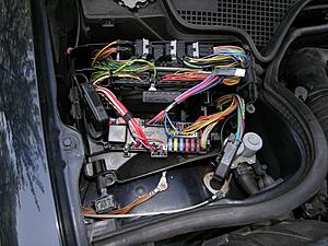

2002 E430... Before I open it up, can anyone tell me what is inside the plastic box located right near the firewall on the passenger side. It's about 12" square and has the emissions stickers on it. There is a pretty loud noise like a noisy fan bearing coming from it when the car sits in 30deg or less. The noise goes away once the engine starts to warm up.

control module box Blower motor.Cools the ecu, K40 relay, and other control units.Make sure to unhook the battery before digging around in there.

The EGS has been removed on the picture. I took the EGS out for inspection when I replaced the transmission electric plug last year.

The noise that I earlier thought was coming from the interior temperature sensor fan is actually coming from inside that box. Is that fan readily accessible or do I need to dig for it and disconnect a lot of sensitive electronics.

Thanks - great picture. Do you know if the fan is in sight? Is it the long black item to the left? If that's not it, it must be buried under all the other components.

I don't think there's any fan there at all. Are you maybe talking about the AC cabin air blower? ... if so, that's located in the passenger's footwell under the glove box and very easy to access.
