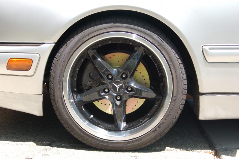

Just changed my front rotors and brake pads with parts I got from Ebay (http://cgi.ebay.com/ebaymotors/98-99...Q5fAccessories).
The total was under $160 (including shipping). I proceeded to install the parts today, bled the brake fluid (with ATE Super blue) and bedded the brakes afterwards. Surprisingly, the pads' binding were comparable to the ones I had previously (Axxis Ultimates). If there was one criticism of the rotor/pad kit, it would be the missing hole for the brake sensor (no problem, I just drilled one). Otherwise, it exceeded my expectations (especially for the price).

you did not get the memo.don't use cross drilled rotors on a w210.
you will not gain any performance advantage(you will actually add braking distance)
and you will end up with cracked rotors.Unless you are one of the few that don't. dimpled are fine,cryo is great,cross drilled are dangerous.
good luck at any price

Oh, I got the memo alright. Actually, I had some cracking experience with cross-drilled rotors on my Miata... but I tracked that car.
I'll let everyone know how well these hold up. =P
