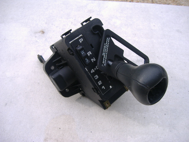

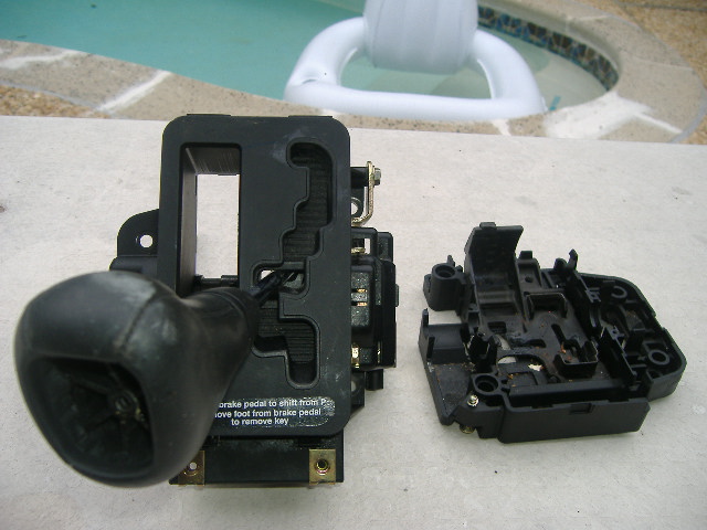

I posted before and found out that the reason why my e320 wouldn't shift up after 2nd gear after my brother left the sunroof open during a rainstorm was b/c the shift module got damaged. So I looked at the DIY section and have gotten to this point (see below photos).
Where exactly is shift module?
How can I repair it (can I)?
How do I replace it (does anyone have any deals, know anybody)?
What should I do?
Attached Thumbnails HELP Transmission Problem?-dscf1511.jpg   HELP Transmission Problem?-dscf1512.jpg   HELP Transmission Problem?-dscf1514.jpg   HELP Transmission Problem?-dscf1513.jpg
Old Sep 7, 2009 | 05:32 PM
aryanvahedi's Avatar
Joined: Sep 2009
Posts: 6
From: baltimore md
w210 e320 1998
I don't get it
I went to the DIY forum but it only talks about removing that entire shifter assembly (what exactly is that whole assembly I have in piture called so I know where how to buy replacement part?); It does not saying anything about reaching the module chip or really how to clean it; so can someone tell me how to do this, I can't see how to replace cover with the gear letters on it somebody plz help me with this.

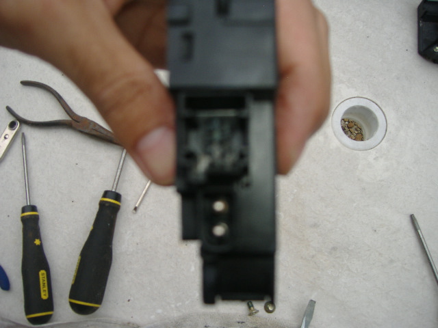

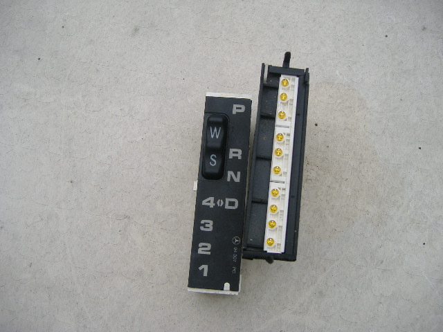

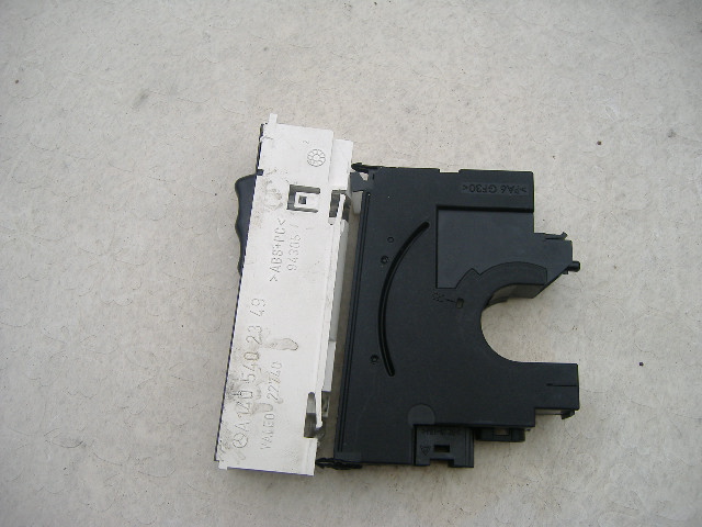

The next step
I have separated the components of the shifter assembly; there is no chip is that location as the DIY shows, so where do I clean in the components I am looking at the black part with the LEDS for the gear numbers but that all it appears to be: LEDS dor the shift numbers.... where is the module I am to clean?

yOU
NEED TO REPLACE THE WHOLE UNIT.
You can't really take it apart to clean and dry it.
If it was going to work it would have dried with a fan blowing on it but since you said you drove it a fair distance I am pretty sure it is fried and you get a used one and reverse the removal procedure and replace it.Then drive.
DIY on www.benzworld.org
w210 forum in the diy section at the top of the page.

Actually I did see a chip in the black thing with the leds on it, I cleaned the chip with alcohol solution haven't put it back in the car yet, will do tomorrow. Doubt it will work but Ill give it a try Didn't you say u know where I can get the part on a deal? If so let me know. Heard bout some limp home thing, which I dont have a scanner for. Either way thanks for your help, Ill let ya know if it works tomorrow.
