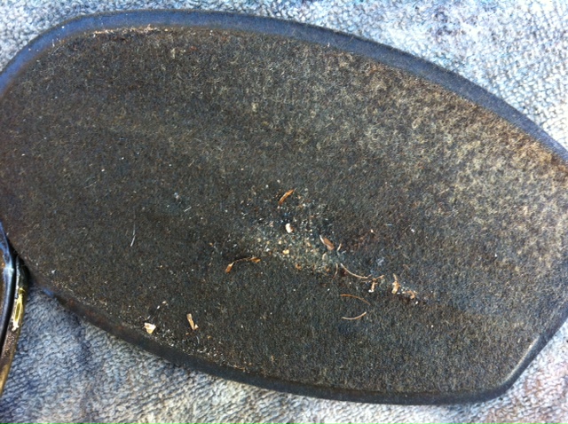

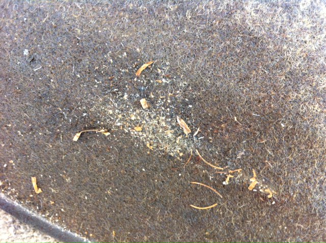

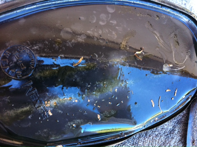

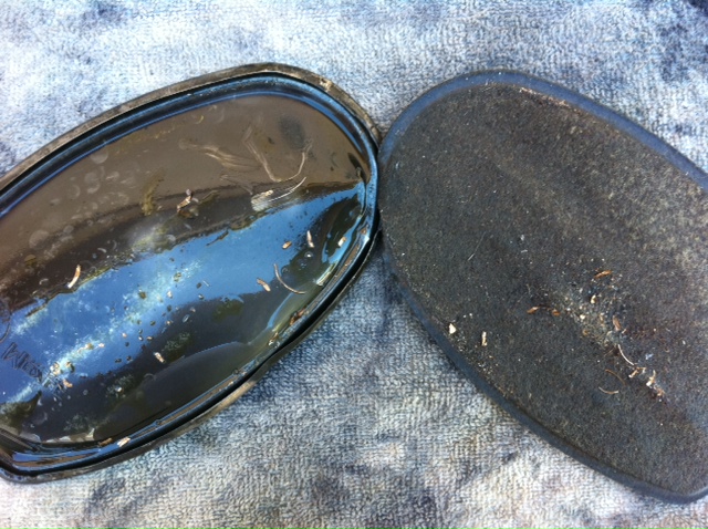

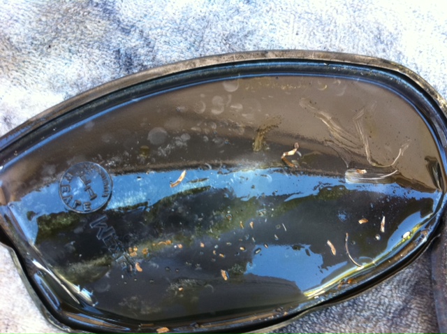

But unfortunately, I found brass or copper shavings upon breaking open my transmission filter. (See attached photos.) I have no idea if they are fresh or if they've been there awhile, and regardless, am worried about what it could mean and if there is any additional service that should be performed imminently before anything gets worse.

codes clear now?
out of limp. drives fine. all fluid replaced,drained torque converter?
If so drive it. If that was the first fluid change wear particles are just part of normal wear and partly the reason to change fluid.

Thanks so much OhLord. Glad to hear they seem like normal wear and tear. I think this may have been the first service, or the first service in many thousands of miles. The tab was broken off the dipstick tube. There was a funny shaped bit of metal in the pan that caused me a great deal of concern until I realized that it was a magnet, and it seems like something that could have been left in from a previous service. (I'm hoping that there are not other places in the tranny where this chip of magnet may have come from.)
On the torque converter, I got stumped on how to turn and access the drain so I ended up skipping it this time around. I know it can't be drained on later models anyway, so thought that might be OK, especially as my main goal was to get to the root of the limp home mode and any issues causing it.
Plus, I want to crack the pan open again in 3 to 6 months to check for any new shavings, and I want to put a magnet in since I didn't have one on hand for this repair. The magnet that was in the pan didn't seem very helpful and it made me nervous just sitting at the bottom. I'd rather crack it open again and put in the mercedes magnet.
