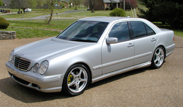

I have the E55 AMG Bilstein shocks with Eibach springs on my 2000 E430. I found a set of E55 springs and shocks on eBay for a great price. I sold the springs because I already had the Eibachs.
I really want the sway bars, but they are pretty expensive, even with the 20% discount I get at dealer. Getting them installed cost a bunch, too.
I have no problems with the Eibachs and E55 shocks. Firmed up ride over stock and lowered it a bit.
