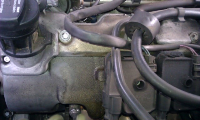

Second oil leak photo
Can't figure out how to attach more than one.

breather cover is leaking. remove, clean, reseal with RTV silicon. Best when done along with spark plugs, wires, valve cover gasket, break cover hoses.

Thank you for your help. Everything else seems okay but will check valve cover leaks. Due for 60,000 mi. B maintenance in 1000 mi. Will reseal with RTV Silicon and see. Car runs well.
