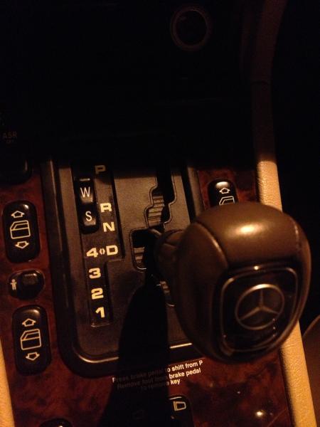

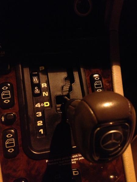

I've attached two pictures to demonstrate what I meant by there are two positions in the Drive mode. Both pictures were taken at night so that the light on my shift panel can be seen.
In the first picture, my stick rests in the "forward position". The light is off, and my car doesn't shift out of the first (or second) gear.
In the second picture, my stick rests in the "backward position". The light is on, and my car shifts normally. (You have to look closely at the picture to tell the light is on.)
This means my shifter module has a poor contact problem. Is there a decent chance that I can disassemble the module and fix it?

*also from your pics something is funky is going on with your shifter for sure. Rather is glass in there or something spilled at one point and now it's just acting up-
