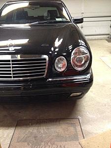

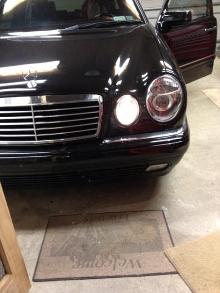

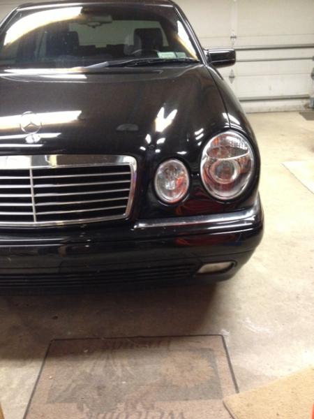

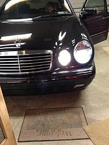

Here are a few pictures, the 2nd parking lights, 3rd low, then last the high beams, found it unusual the high beam lamp is located in the marker light housing, The PO installed the lights stated they would never need to be replaced? Also stated the headlamps ($1000) and rims ($5000) cost more than I paid for the car?
So is there a soloution to get the flash to pass feature back?
Plutoe: To use the feature just pull back, release, pull back the stalk a couple of times------if that does not work your switch is most likely bad.
