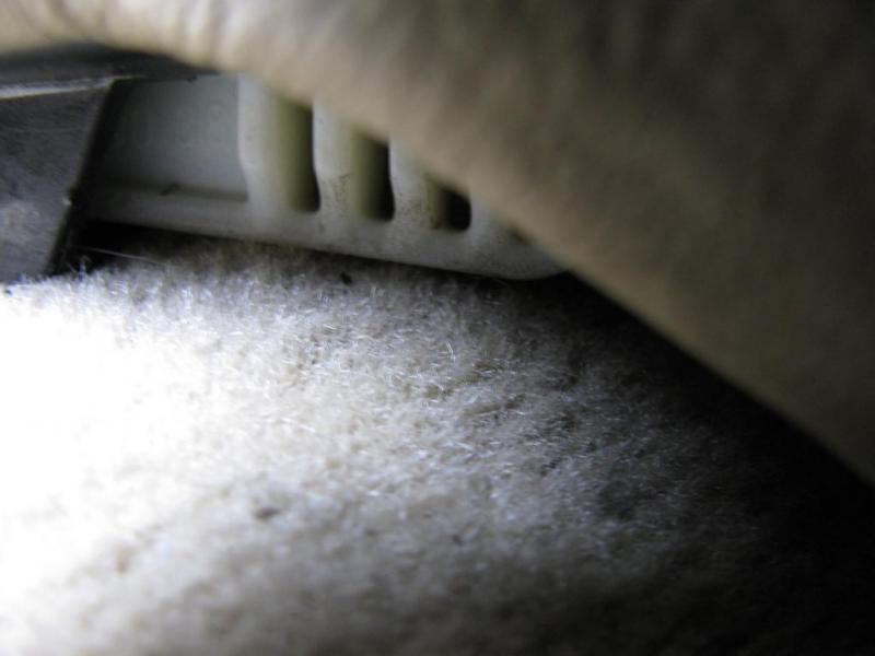

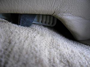

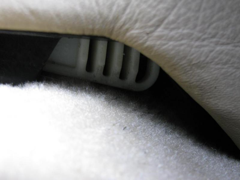

1996 Mercedes e320 Rear Seat Removal

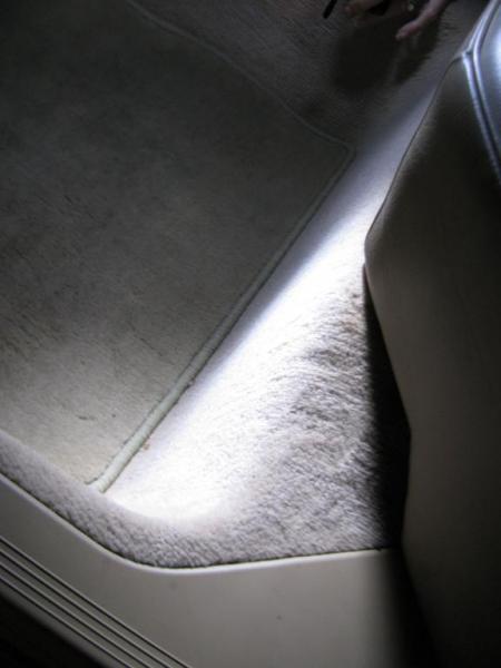

I cannot figure this out and the instructions I have recieved from people do not seem to work on this. Please view the photos and I would appreciate anyone explaining how this is done. The photo shows a plastic black thing and a plastic white thing. The photo location is of the front of the rear seat, towards the floor, on the drivers side close to the door.

slide your fingers underneath the white plastic and lift towards ceiling
you can use the SEARCH function on this forum and find other suggestions
p.s. try pushing/pulling the seat around a little on the chance that it may
jog the catch into releasing.

Thanky you for responding. I did search, the instructions seemed to vary alot. To be sure I understand
-Do not push white piece back towards trunk of car
-Do get fingers under white piece and lift towards ceiling while kneeing/pulling the seat around?
Old Oct 13, 2013 | 06:14 PM
jvt33232's Avatar
Joined: Oct 2013
MBZ
Your advice worked great, thank you very much. The white thing you you move straight up towards the ceiling.
