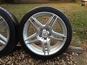

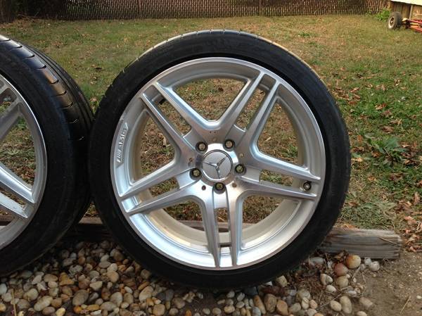

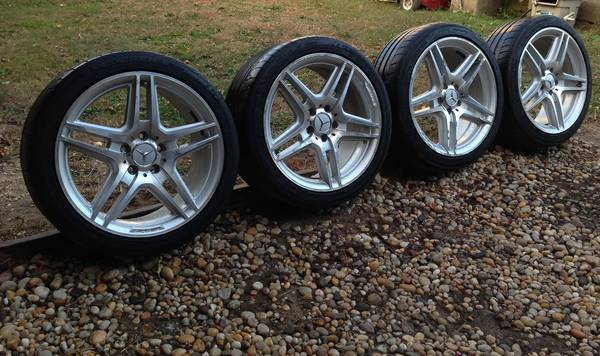

Hello everybody,

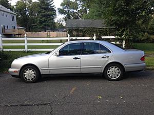

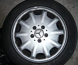

I have a 1999 E300 Turbo Diesel Sedan with stock factory 215/55/R16 wheels. I am looking into upgrading my rims and I found a beautiful set off factory original AMG wheels off of a C63 AMG (I think they have a offset of ET50). They are both the same bolt pattern 5x112. I forget thew tire size, I think its 225/45/R18. I know it should be fine.
Mostly I'm worried about the offset being too high.
I am not looking to lower my car, roll the fenders or anything else. I will purchase any necessary lugs to put these rims on.

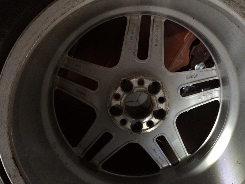

Attached are a few pics showing my stock rims and the 2011 C63 AMG rims I'd like to purchase and install.
Can somebody who has had experience upgrading wheels on a w210 please give me some advice on this.

yes, you're doing your homework and just need to carefully calculate to see
whether the 225 with 8" width, with 10mm spacer will clear the wheel arch.
you'll need longer bolts and with hybrid 12mm ball seat. the length will depend
on the cross section of the new rim so measure the protrusion out the hub end
of the rim. it should not be more than .5-.75" or it could impact the parking
brake mechanism

C63 wheel size
To start with you didn't say what he C63 wheels sizes are, I have no idea what these rims are except they are most likely machined for 14M lug bolts.
width x diameter x et is cast into the back of most MB wheels, thats always the place to start. I beleive all mercedes wheels are 112 x 5, so that imformation is useless. Post back what the sizes of the wheels are, and are they staggered, (wider rear rims)?
Unless these were free, or so cheap you had to have them, go buy some wheels that are naturally a good fit to a 210. I know there are folks who use spacers often,but I wouldn't bother.
There are many nice looking wheels out there that would fit perfectly. just be patient and by ones that fit the car perfectly.
But if you do end up with these c63 wheels, the lug bolts needed will be 12M threads for the 210 wheels hubs with 14R ball seats to match the wheels.
Shank length needs to be 17 to 20 mm out the backside of the wheels, I see you have the link to the lug bolt guys, they are expert and will get you the right bolts.

The wheels are 18x8 / 8.5 et 50 / 54 with a 10mm spacer they should fit ok but I would test fit before buying.
