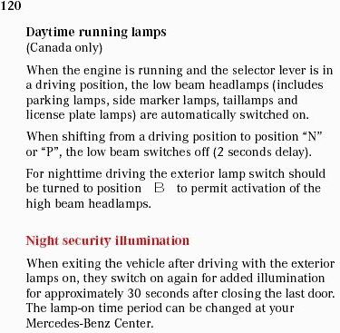

On the 2002 the Lights
From the manual regarding Fog lights and Security Illumination:
Note:
With the electronic key removed and the driver’s door
open, a warning sounds and the message “SWITCH OFF
LIGHTS!” in the multifunction indicator appears if the
vehicle’s exterior lamps (except standing lamps) are not
switched off.
Fog lamps will operate with the parking lamps and/or
the low beam headlamps on. Fog lamps should only be
used in conjunction with low beam headlamps. Consult
your State or Province Motor Vehicle Regulations
regarding allowable lamp operation.
Fog lamps are automatically switched off when the
exterior lamp switch is turned to position D.
Night security illumination
When exiting the vehicle after driving with the exterior
lamps on, they switch on again for added illumination
for approximately 30 seconds after closing the last door.
The lamp-on time period can be changed at your
Mercedes-Benz Center.
Attached are pictures from the manual.

Thanx EddieGTP, that explains it (and answers Mr Kato's query) but fact is, I don't have the "Night Security Illumination" feature so no lights on problem ......maybe only needed in the US, errr ,where you guys haven't invented street lamps yet?????
