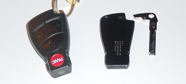

Well I used to own a 99 E430, so I'll see if I can help you a little bit:
1)Interior center console is different; radio, esp, a/c controls.
2)Keys are different as well as their functions.
3)The outside looks more or less the same with the exception that the 97 and 98 have infrared receivers visible all over the car. the most obvious to the left of the trunk key hole. 1998 saw a handful of updates compared to the 97, besides t he engine change. Also I believe 16's came standard on the 430 in 98 vs. 97. Xenon's were first offered in 98 and on. 1999 had a few changes on the interior compared to the 98, but not much difference. 98 was also the first sport model years available. 2000 saw the biggest update for the 430, with outside changes in bumpers, skirts, headlights, tailights, steering wheel with controls, transmission with + or - shifting. yet still a five speed.
If you go on Ebay, you can look at the interior shots of the 97, 98, 99, and you will see what I mean about he center console updates. If you have a question on switch locations in each car as to what they are, I am sure we can help you out if you are not familiar.
I hope this helps.

The 1998 also has the current Infared Smart Key. This system can not be defeated. The car has to be towed away or gun in your face carjacking. Look for Xenon HID headlights if possible.
