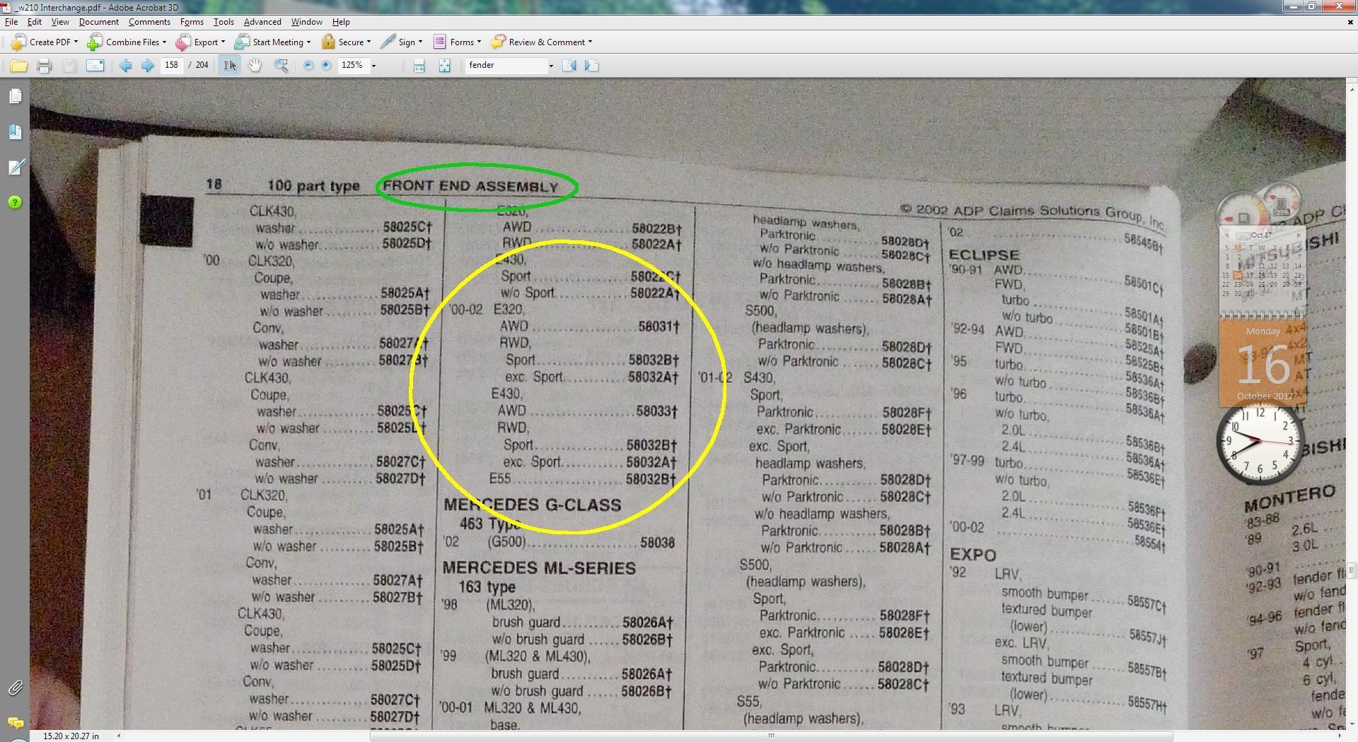

Hi, I have a 2002 E430 4MATIC and looking to replace the front RH quarter panel due to a lot of rust/bubbling in two separate areas. I was thinking about going aftermarket but it may be cheaper to get a used part since I could avoid the paint job. I see a 2001 E320 front RH quarter panel for sale around my area in same color black. Does anyone know if this will be a exact fit? Thanks.

it MAY, but there are slight differences between RWD and AWD so your VIN would need to be plugged in....or that you're willing to do some pounding, bending and welding. the wrecking yard guys should be able to plug your VIN into their :"interchange" database. if your local library has a set, look for "Hollander Interchange Manual"
