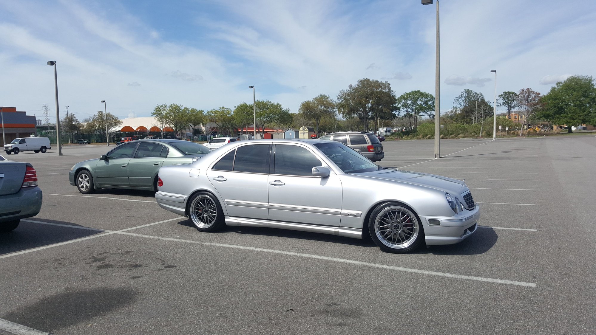

running 18x8 front 32mm offset
18x9 rears 32mm offset
10mm h&r spacer front
5mm rears
235/40r18 and 265/35r18
springs are eibach with #1 mercedes spring pads all around.

@convert190 looks good, what kind of wheels are those?

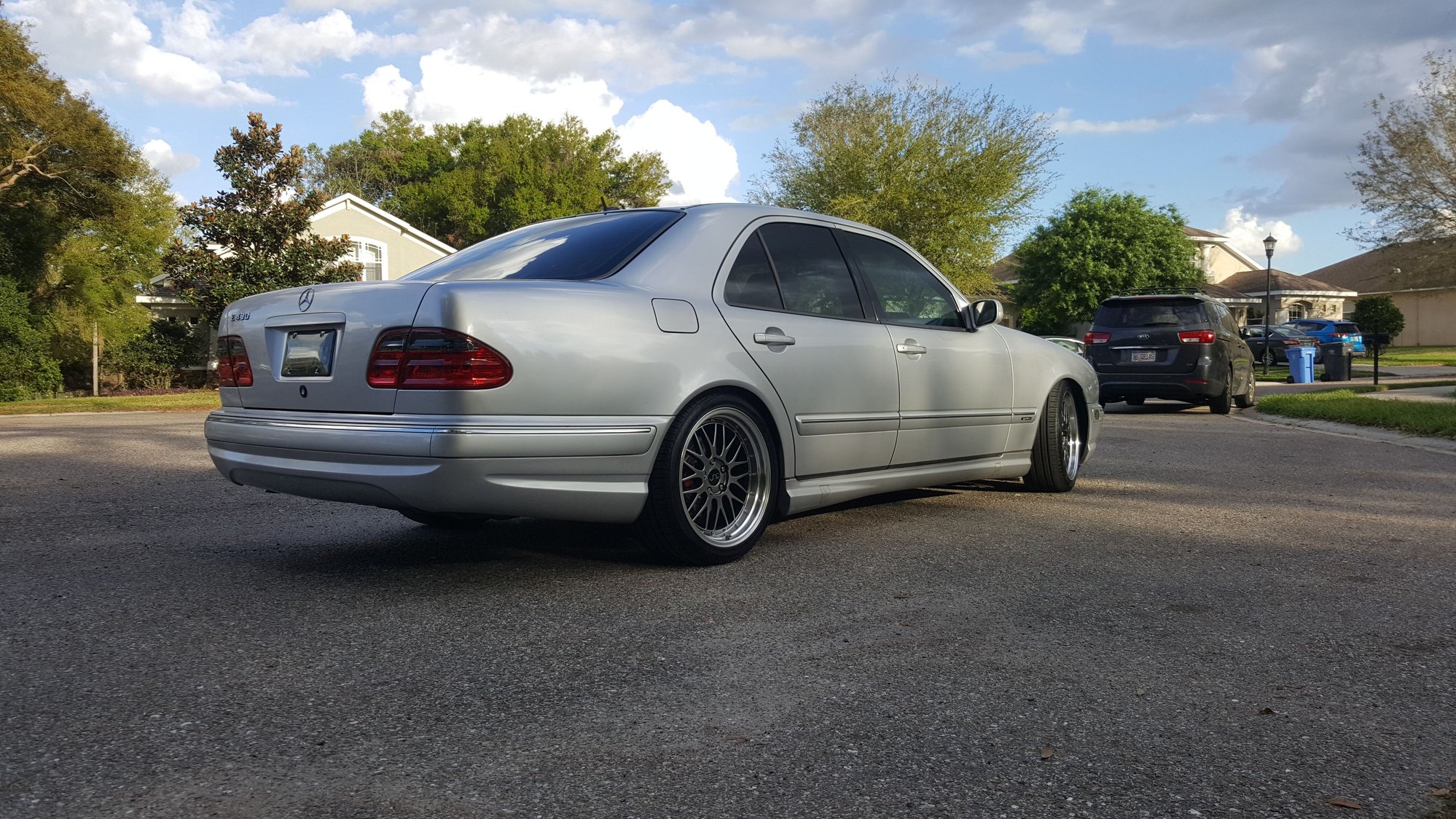

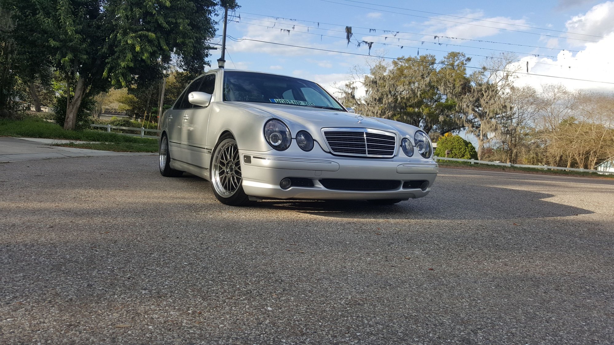

Old pic of her but same suspension setup.
18x8.5 front 18x9.5 rear. 225/40 front and 245/40 rear. 28mm spacer in the front and 14mm spacer in the rear with camber arms. Dropped 3.5-4 inches on K sport coil overs and Koni yellow shocks.

these are jdc wheels from ebay 580.00 for the set shipped lm replicas
