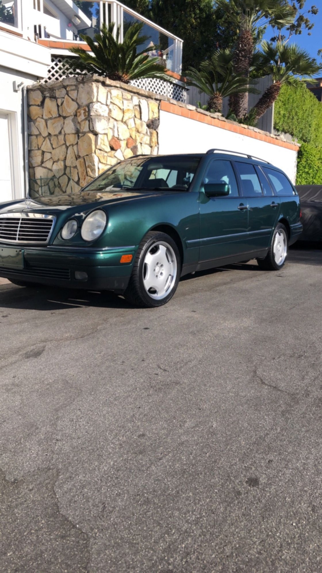

Hi guys! I’ve purchased some rs1 lorinser wheels for my w210 wagon and need to find out the proper lug but to put on the car. I’ve purchased a set for the spare tire as my car did not come with one and they thread in 3 turns which is not enough. Also I am getting a violent vibration front and rear. All wheels have been balanced and they were all less than 1.50 out. I’ve been doing my research and it’s all been pointing towards hub centric rings. If anyone could point me towards a store or website where I could purchase these things it would be greatly appreciated!
