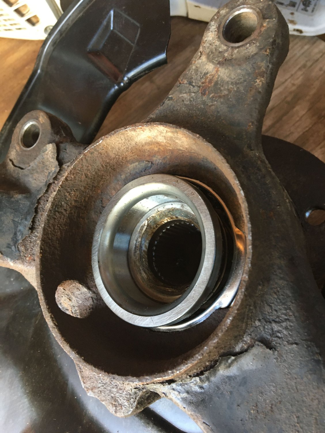

Hey folks. I was almost done. I just had to push the wheel hubs back into the driver knuckles and this happened.
I don't know what I did wrong. I pushed the wheel hub in and pushed out the inner race doing that. I guess I've destroyed both these new bearings as well.
Was I supposed to place a spacer under the inner race to support it while I pushed in the wheel hub?

Yes, when putting the hub in you want to press against the inner race, not the knuckle. Try pushing it back in, but if you damaged the ball carrier at all, yes that bearing is trash.

And yep. Weeks of work, should have been done right now. Thanks for the info ItalianJoe. I can't believe i did this but I pretty much knew right away I had missed a crucial step here Dang it!
