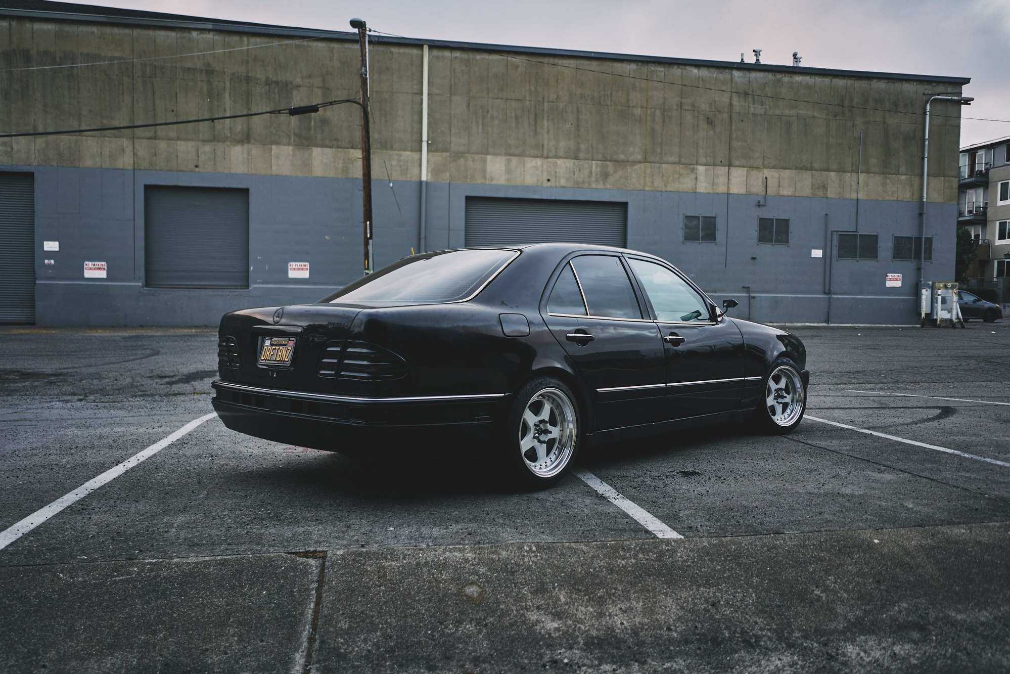

Some photos for attention and to let everyone know I'm serious.
