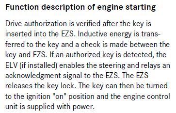

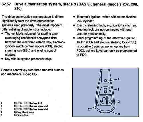

Motor Electronics, steering lock, key fob, and ignition switch (aka EIS) are all coded to the vehicle's VIN. All must match to work.
A key fob can run you several hundred dollars (IIRC, I paid ~$300 for a key fob for the '99 E55 and $398 for a key fob for the '05 E55.)
You can clean the nose of the key fob as there is an infrared transmitter in it that "hand shakes" with the ignition switch.

Be sure you have ensured that BOTH the key FOB batteries are healthy.... AS WELL AS the car battery beneath the seat. If the car battery is low the ignition/security system will be erratic. Car battery should be over 12.3vdc... definitely shouldn't be below 12
Originally Posted by Plutoe
low voltage will also prevent the key from turning----whats yours and dont be suckered into buying a preprogrammed key as the only place you should be is at a MB dealers parts counter and have all your ownership documentation as keys are "theft revelent" parts
