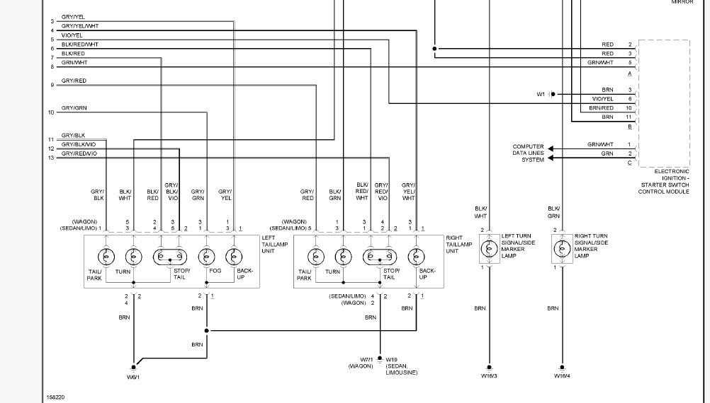

Instead of grounds, try ensuring you have voltage being applied. This is from a 2002 W210 schematic I believe. I can't see them modifying the tail light harness at the end of the production run. If you don't have power, then back trace until you find the corroded connector or the broken wire.

Very impressive repair !!! The taillight assembly is new so I believe I am past replacing parts and on to wiring. I really appreciate the diagram and agree it would be unlikely for MB to change it...I will get to it soon and let you know what I find. Thanks so much !!!!
