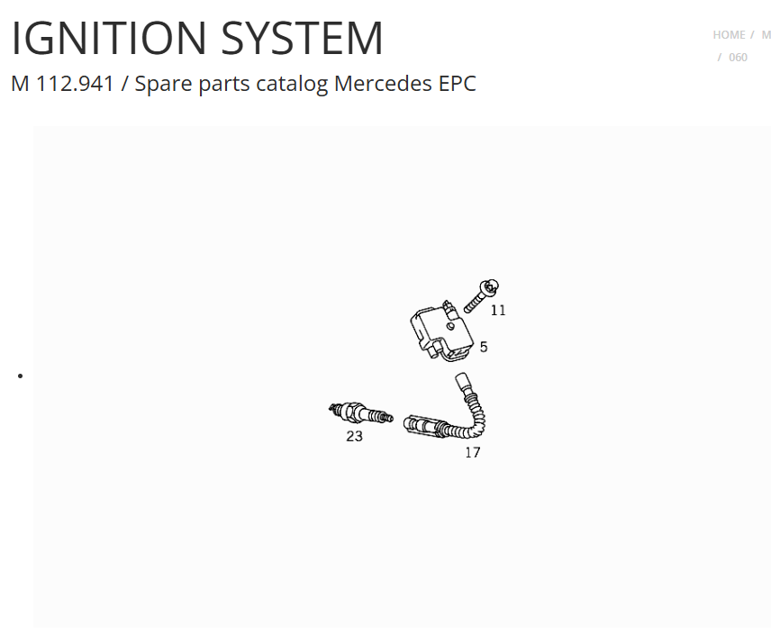

Here are the part numbers for an E320 after model year '00.
https://nemigaparts.com/cat_spares/e...asis=21006566Y
Verify that matches the engine that is in your car.

Is it the M112 engine?
Parts diagram shows two different part #'s for the wire.
- 1121500218 x 4
- 1121500118 x 8
Old Dec 10, 2025 | 01:15 PM
