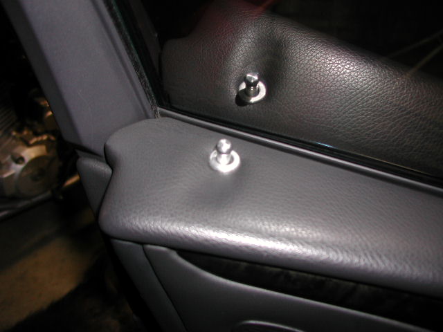

Door lock pin surrounds? I got the Brabus pins by themselves and they look great. then I decided to get the brushed surrounds that match. The pins rattled inside them like crazy! Getting the surrounds out is now impossible without destroying the door panel. I solved the problem by adding a tiny O-ring to the upper most groove that's machined into the door pin. Now when the doors lock and pins drop, no more rattle.

As soon as I noticed the rattling, I tried to pull the surrounds out and go back to just the pins. That's when I realized there's no way in hell they're coming back out! The surrounds have a smaller diameter hole and the stock "golf tees" couldn't be re-used! AAAAAARRRGGGHHHHH!!!! That's when I came up with the O-ring idea:

Looks good my man.
