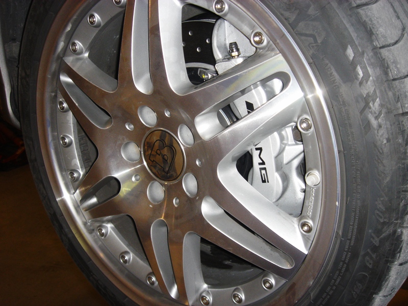

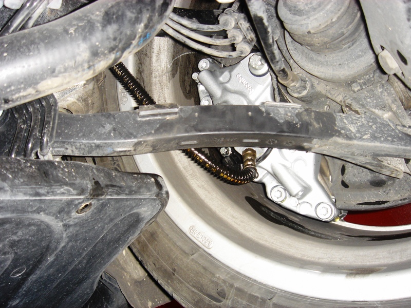

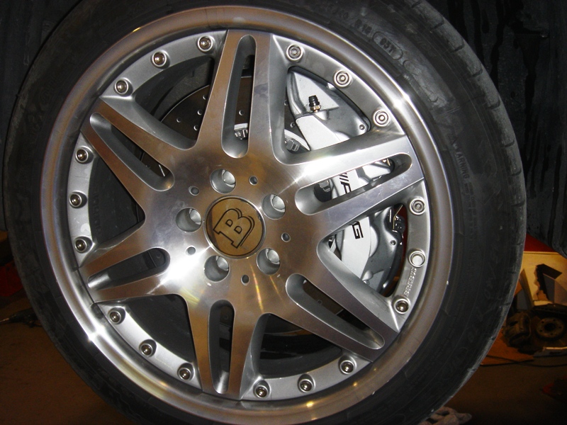

Old Dec 12, 2005 | 11:11 AM
rubensans's Avatar
Joined: Jun 2003
Posts: 958
From: Barcelona-Spain
Brabus K3
Originally Posted by AJU_E350
Do you have any pics of these ? Did you do this swap on your E yet?
Where can you buy them???
Any pics?
Old Jan 18, 2006 | 03:05 PM
rubensans's Avatar
Joined: Jun 2003
Posts: 958
Brabus K3
Thumbs down
Originally Posted by MARK CUMMINS
One can Upgrade to the SLK55 Brakes..Front and rear! they will fit..Six piston calipers up front....Looks Great!
I'm sorry but they don't fit.
I have buy the brakes of the SLK AMG and they don't fit.
1.- Backing plates needs to be cut or changed to SLK ones, you can bend them but it's not enought.
2.- Disc holes for bolts on SLK are 13mm because wheel bolts are 12mm; in E disc holes for bolts are 15mm because wheel bolts are 14mm. So you have to make the 13 mm bolts larger to 15mm so the wheel bolts can enter.
3.- The SLK discs are more to the outside than the E ones, then the caliper is too much inside. You have to do new caliper mounting brackets so you can center the callipers with the disc.
4.- Calipers touch 2 mm the suspensión arm. Maybe this is only on airmatic's, but you have to sand 3mm the inside corner of the calliper.
I don't see the way they can fit without big modifications. Are you sure your friend put the SLK discs on a E? I know they are compatible the SLK and CLK, but it's sure that they aren't with E.
Now the problem will be manufacturing new mounting brackets.
Best Regards.
Old Feb 7, 2006 | 10:12 AM
rubensans's Avatar
Joined: Jun 2003
Posts: 958
Brabus K3
You also cannot put rear SLK/CLK 55 brakes because:
CLK/SLK 55 Rear calipers are leading and E55 rear calipers are trailing.
Best Regards.
Old Feb 21, 2006 | 06:06 PM
rubensans's Avatar
Joined: Jun 2003
Posts: 958
Brabus K3
I finaly succed to install SLK 55 FRONT + E55 REAR.
E55 REAR are plug and play.
SLK55 Front need a lot of work.
Best Regards.
