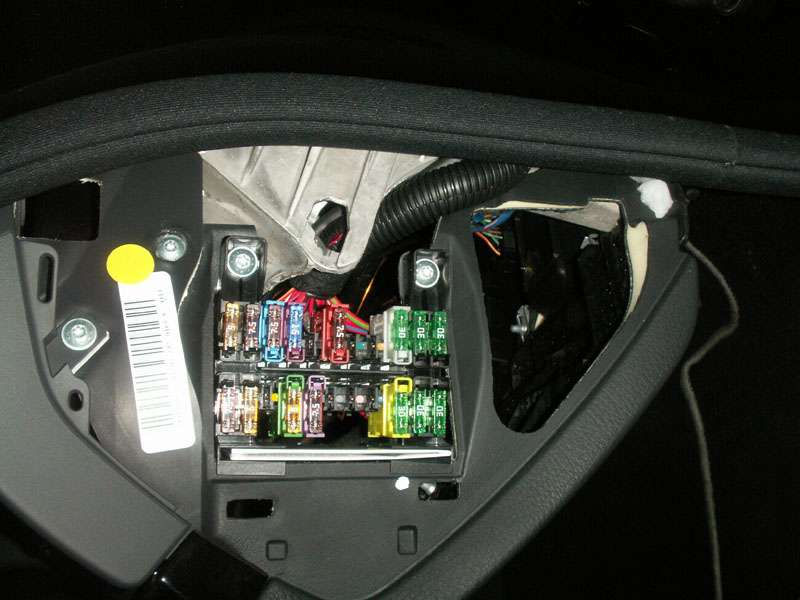

can i get wire from my fuse box? How?

i tried and couldnt find anything switched there...went with the cig lighter for switched power and used a point in that panel for my ground
