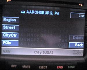

updated my command and look what happened!!
I lost the ability to enter a destination while driving. all what i can do while driving is either to enter destination from the memory or POI in [U]the current location [U]only.
as you can see in the picture below, it highlights Aaronsburg, PA and you cann't select another city unless you want to use the list option (which will take you forever to get to Washington, DC for example) or you have to stop the car.
the only positive thing about the update is I got the ETA at the bottom of the display.
Would be possible to change with DAS, if your dealer is willing to do it. Not sure if it is legal in the US, at least the W221 I've heard is like this in the US but not in Europe.

I dissagree. It works great in my car and I have all the functionality I had before + the ETA info. However, I didn’t go the upgrade myself but had the dealer do it. They did it under warranty and I don’t know if that makes a difference as to the ability to enter dist while driving.
My suggestion is to take the car to the dealer and have them do it under warranty or pay the $40 it would cost in tech time.
As for MOZART I suggest that you take the car to the dealer and have them correct the issue through DAS. There was another board member that had the same problem and he got it corrected at the dealer so it is possible.

Very strange Mozart....are we safe in assuming that your command is U.S. AND that the dealer did the upgrade?
I did the update myself and did NOT lose the destination entry function, as other members posted in Konigstiger's original thread.

I did the update and no problem at all. I can enter the address while in motion. I updated the comand bc I like to keep my software current.

Yep, add me to the list of the ones that can't input destinations while in motion. I'll talk to my SA this week and see what we can do. I've got a pretty good relationship with them so if it can be fixed, they'll do it for me. I'll report back.
YEAP me too.
I can only use the list buttons. the letters and numbers keys are greyed out when the car is moving. but I could load an address using the addresses that are already in memory...
Yeap, me too.

the update didn't brake the Nav. it just made it safer.... I could still enter address in motion via recent or saved address. my Chrysler Nav was like this. all so I notice that if I'm talking on the car phone while use the Nav, the Nav will not say the direction out loud. I guess people thought it was rood
