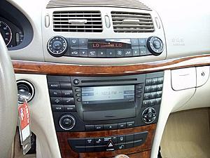

2003 E500 stereo/nav questions
I am about to pull the trigger on a 2003 E500, but I noticed that the radio display looks different than all of the others I've seen in 2003+ E class cars. The display is much smaller than the ones Ive seen in other cars. Can this unit be replaced with a COMAND relatively easily?
thanks
ccie6679

I suppose a picture would help
Attached Thumbnails 2003 E500 stereo/nav questions-2003e500_display.jpg

This is a pretty straight forward upgrade that will run about $700-$800 if you do it yourself. Pulling the old unit out and integrating the new one is going to take about 45 minutes (or less if you know what you are doing). My recommendation to get a Euro COMAND with DVD playback. There are two versions of Euro COMAND on the market -- one allows to add a TV tuner and the other one doesn't. If TV tuner is something you would like to add later then spend a bit more money and get the one with TV tuner plug. Otherwise, stick with the cheaper one.

No picture needed; I know it well. Nothing like a cassette player for those Greatest Hits of the 70s compilation tapes.
That unit (I believe it's called an Audio 50) can be replaced with a 2004+ COMAND. Whether it can be replaced relatively easily (or cheaply) depends upon your definition of easy or cheap, I suppose. For several years a guy named Steve from the Netherlands (MbenzNL.com) has been travelling to various points in North America to perform upgrades like that. Don't know if he is still doing that, but I see a recent thread ("Atlanta installs ...") from a Sunil @ Motorwerks that seems to offer the same kinds of upgrades.

I got one of these too (Audio 50). One of my next upgrades is to get one from mbdoctor.com for around $1,300.00. As stated there is a US Command and two versions of Euro command. US Command does not come with DVD while most the Euro Commands do. Make sure to separate ones that will play music DVD's and those you can play a movie DVD through the dash. Until then we can swap cassettes.

Bought a Euro comand for about $700 on ebay + $100 dealer install. Sold my US one for $500 or so. Worked out well for me.

The monitor on the 2004+ COMAND will be the navigation monitor. Yes, there will be another DVD drive in the trunk. But you won't put movies in there. The Euro COMAND single slot drive is a DVD drive - on the US COMAND it is just a CD drive (but will play mp3 CD's if the software is upgraded).
