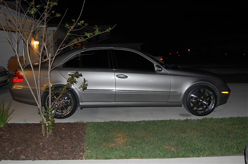

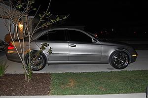

well can you all let me know if i should lower it. ill post some pics so you all can see and let me know. to me it looks like it did but you all let me know.

Wow, that thing did get high up. If I were you I would lower it

With those tire sizes, the diameter is now about 1" taller than OEM. You are about 1/2" higher from the ground. To keep closer to OEM and keeping the same width, you should be running 245/30/20 in front and 275/25/20 in the rear.

The springs definitely should have settled by now.
Visually, yes you should lower it.
Will there be problems, I can't say. I am relatively new to the 211 so I am not sure. I know there are others here running the 1" taller tire specs. Maybe they can chime in. I kept mine at OEM diameter specs to avoid issues.
I have another car that I run 20s. On those, I have 1" taller specs and am lowered. For that car, I rand slightly more aggressive offsets so I modified the fenders and wheelwell to minimize rubbing. Still, on big enough dips at high enough speed, I will still rub the top of my wheelwell. I don't also make full turns as the front will rub a little. There is a price but for that car, I was OK with it.
