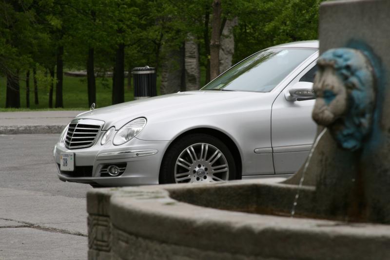

As requested: Daytime and nighttime pics of the clear side markers/bimmian bulb combo.

thanks for the pics
lovely front lip btw
