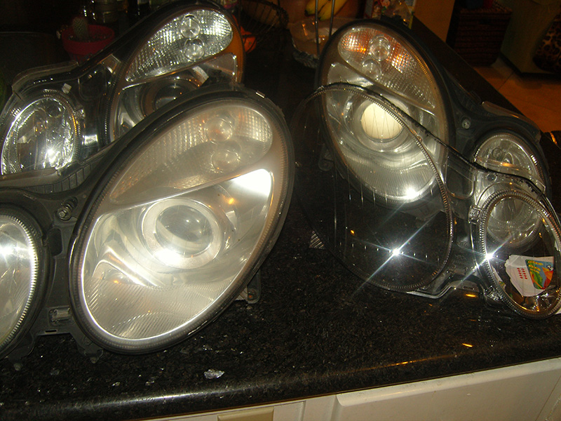

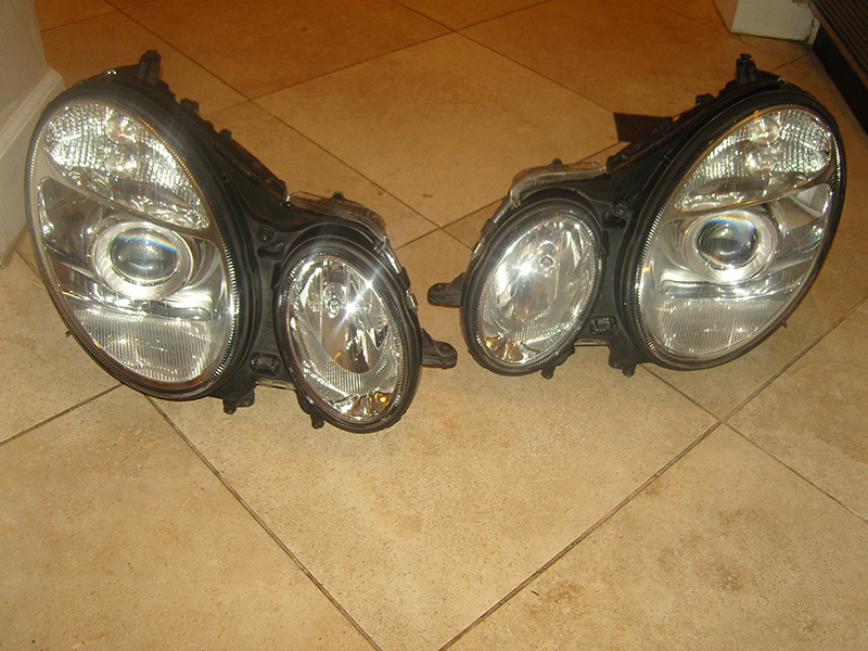

The plan was to merge inner components, electronics, and lenses from the xenon lights with the good housings from my lights. Thats 6 trips to the oven, and some dremel work to create openings for the ballasts and one of the cable harnesses. It took about 6-7 hours and worked quite well. The high beam works, and I removed the cornering and auto-leveling components.

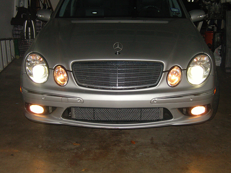

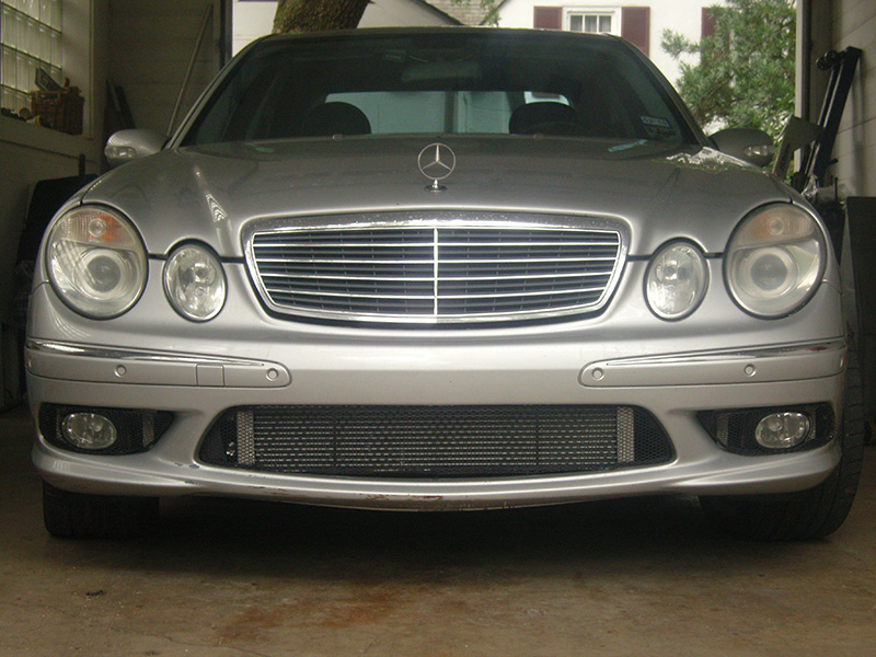

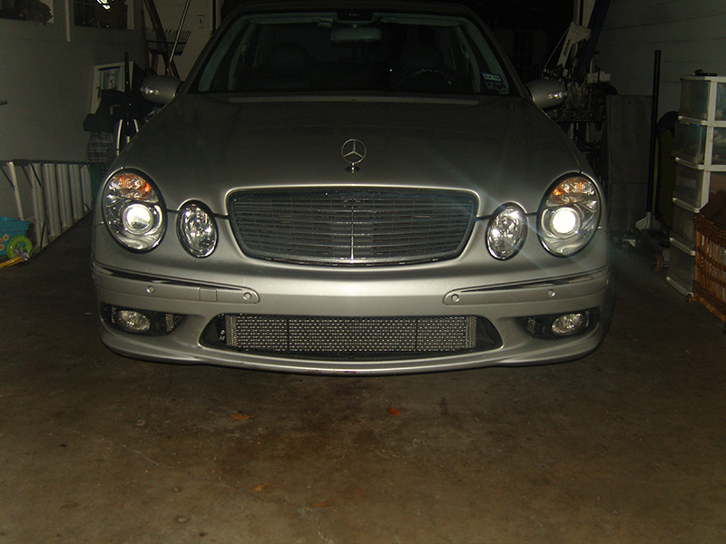

The lights shine steady when the engine is off, but flicker or go out when the car is running, and show a fault. I'm hoping this changes when it gets re-programmed? Here are the pics:
old look with faded lenses:
everything is off:
old lights, a new light, and one of the new lenses:
two merged lights are complete:
installed:
on:

Flickering should go away once you have coded the car for xenons present.

You might have already gotten the computer programmed, but in the meantime make sure you don’t have the daytime running lights on. This will definitely cause the Xenon to flicker. DTRL don’t send full voltage to the bulbs to prolong bulb life (on conventional headlights), with Xenon, they are not dimmed since you can’t dim them.
Technically, you should not have any flickering if you turn the lights switch on manually. But maybe I’m wring about this one.
Looks like great work, I hope that you don’t get any moisture in the headlight assembly in the future though.
