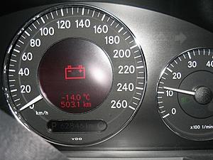

This is different to majority of similar complaints - I get no "Low battery" messages or warnings to visit the workshop. Just a big red screen with a battery pictorial inside: see below.
This is a 06 E350, dealer replaced the aux (engine bay) battery in April due to the same red screen warnings. All was well during summer months but the problem returned now and shows on cold mornings. Car starts and runs fine. The warning can be cleared by switching to the next page on the display.
Any ideas, please?

The cold -14 C (6.8 F) may be adding strain to your battery. I would say that your main battery is probably going bad.

I have just contacted the previous owner, apparently the main (trunk) battery has been replaced about 2 years ago. Hmmm...

Just recieved same message with visit shop.

Replace the aux bat
