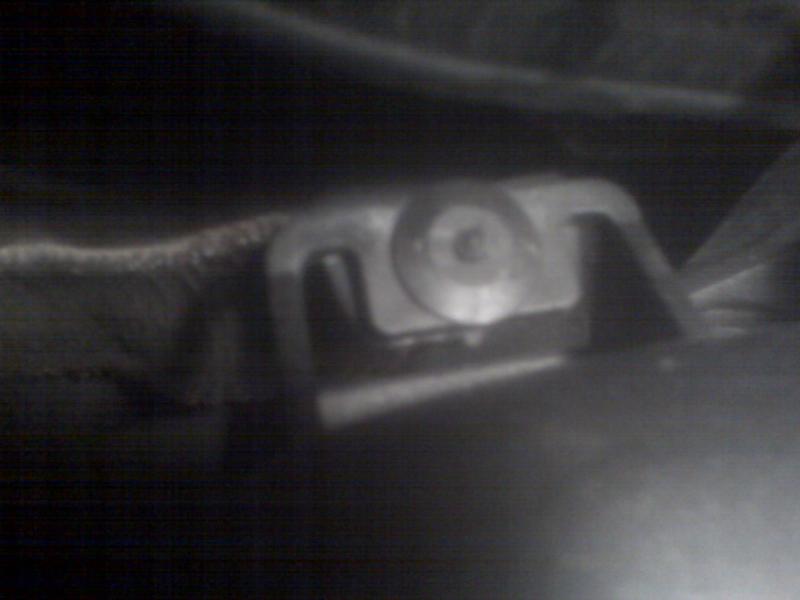

screw?
I'm afraid to even mess around with this, fearing that it will break. Doesn't look like it will screw out

I thought it was a screw, but it just turns in place. If you use a thin flat screw driver, you can pry up on the plastic plug. Remove it completely and then you can move the coolant tank a few inches. I used some twine to hold it in place while I installed my HID lights.

Does anyone know what the part number is for those clips? Just broke it half way off

Rivet part # 1249900492 (#190 in diagram) about a $1
