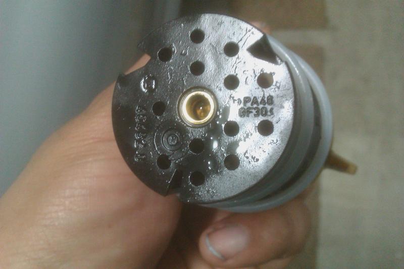

After talking to a few people, I looked and found out it was a transmission connector (part# 2035400253). The repair was not too difficult, just slightly tricky. I will use this link posted by slk230red on benzworld.org for a reference. So thanks slk230red. I didn't use this post when I was doing it. I found it after the fact. I wish I had. haha!!
The repair was pretty similar to slk230red with only a couple of minor differences and observations. This trans-connector is located on the passenger side towards the front of the black transmission pan.

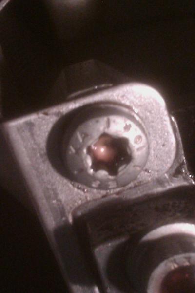

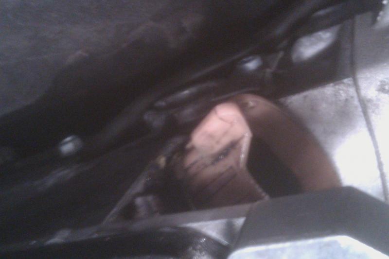

There is a t-30 torx screw (Pic 1 & Pic 2) that needs to be removed. Pull the cover down and it will come out. Then you will see the trans-connector. Turn the connector (using the tab) approx. 90 degrees counterclockwise (Pic 3). It was a little tight so while I was turning the connector, I used my other hand to guide the body harness wiring which made it easier to remove. I did this when I was putting the body harness back as well while turning the tab.
After removing the 7mm hex bolt, the connector comes straight out without too much difficulty. The old one had white o-rings. The new one had black ones.
Putting the new one back in posed a little issue for me. Since the connector tab kept moving I couldn't used that as a guide. So I pushed it lightly and turned it until I felt the groves catch (Pic 4). After the grooves caught, I pushed it in. I was hesitant at first because I didn't want to bend the pins. But with the new o-rings, you kinda have to. I tightened the 7mm hex bolt snugly. Then put the body wiring harness back in and the cover and you are good to go. It probably took me about 25 minutes so it is not too difficult.
