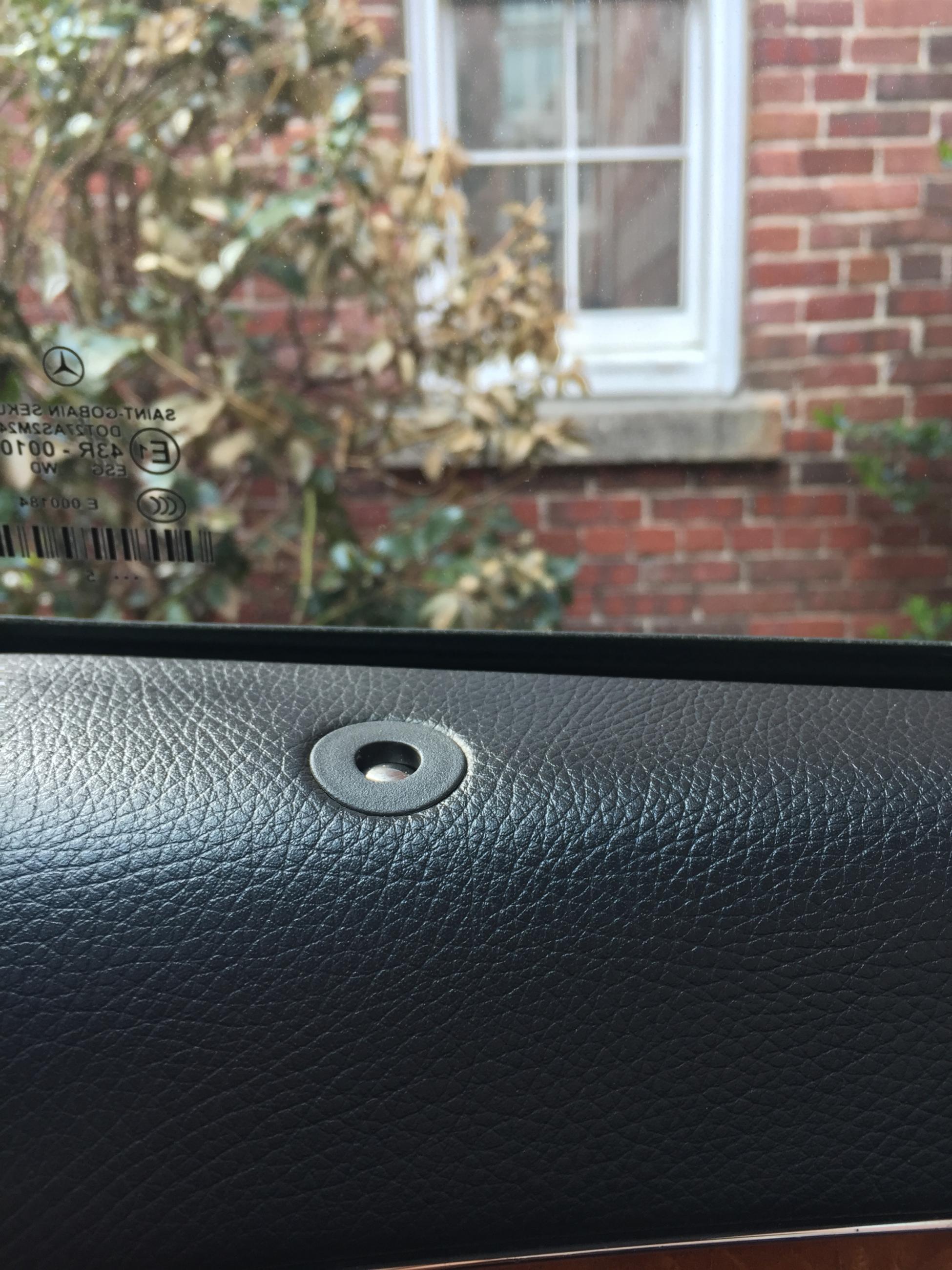

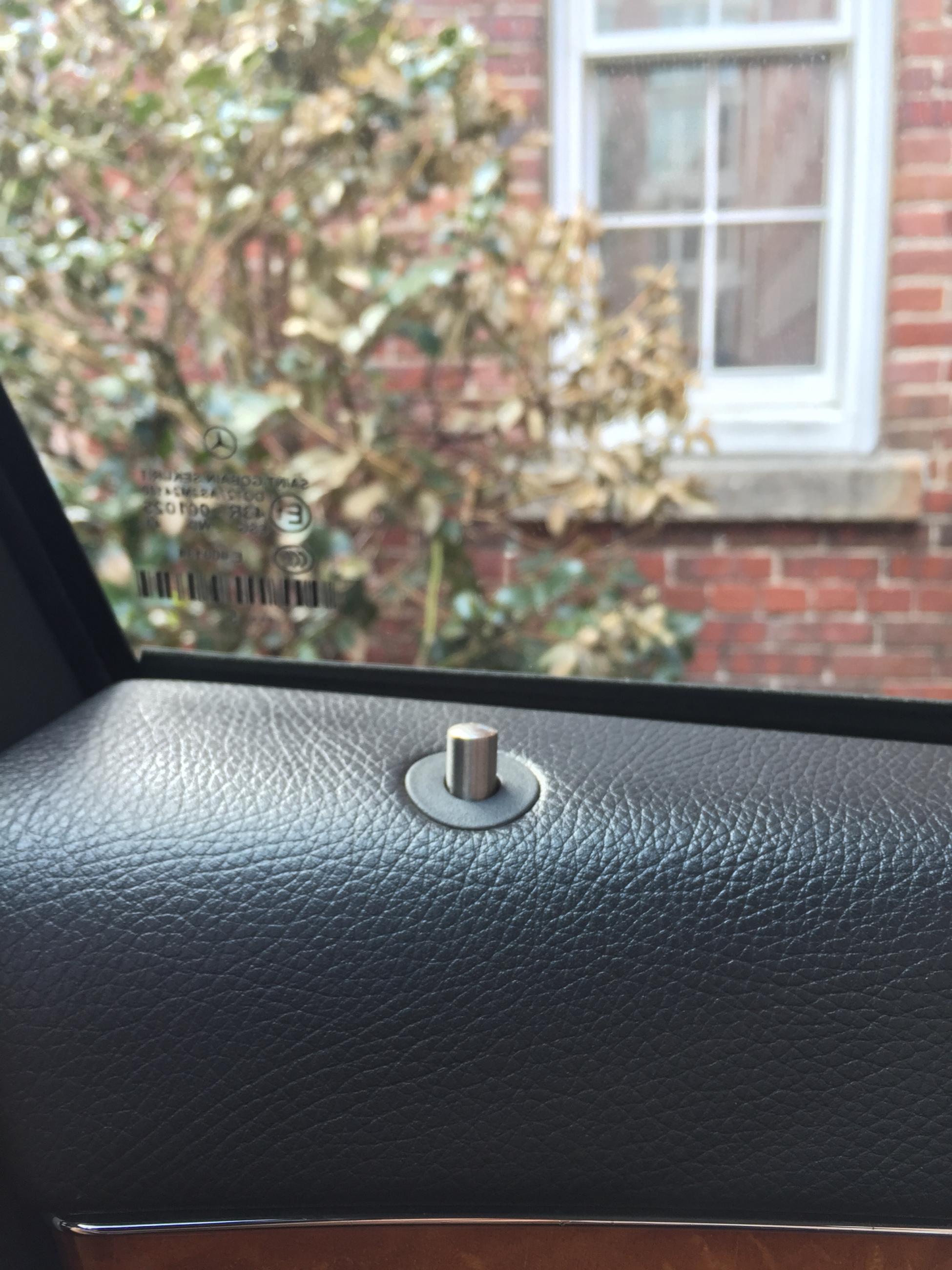

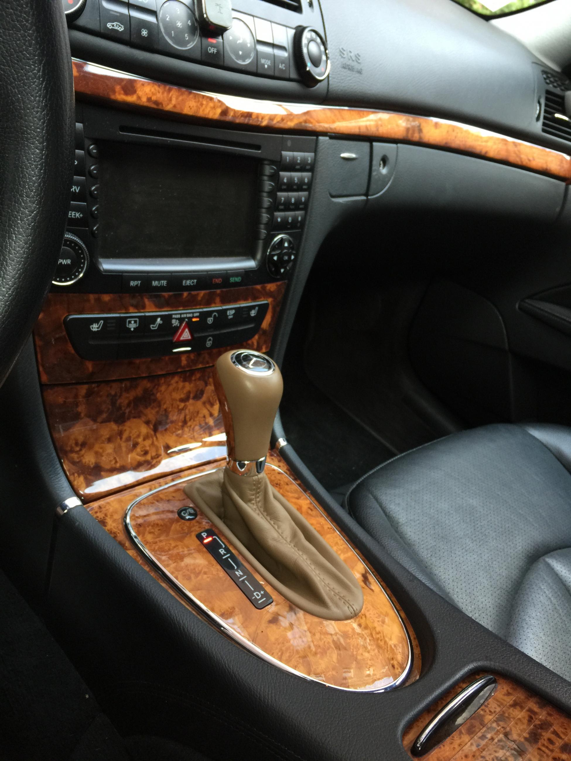

Upgraded my shifter from the pre 06 style to the 07+ facelift style. Went with a beige style shift boot and knob, I think the contrast actually looks lovely in person. And upgraded the door pins as well.
Next mod: 07+ front fascia facelift

Where did you get the door pins?

Search "w211 door pins" on eBay, these are the ones I got:
http://www.ebay.com/itm/03-09-Mercedes-Benz-W211-E-Class-E350-E500-Stainless-Metal-Door-Lock-Pin-E63-AMG-/251428059584?hash=item3a8a47b9c0&vxp=mtr

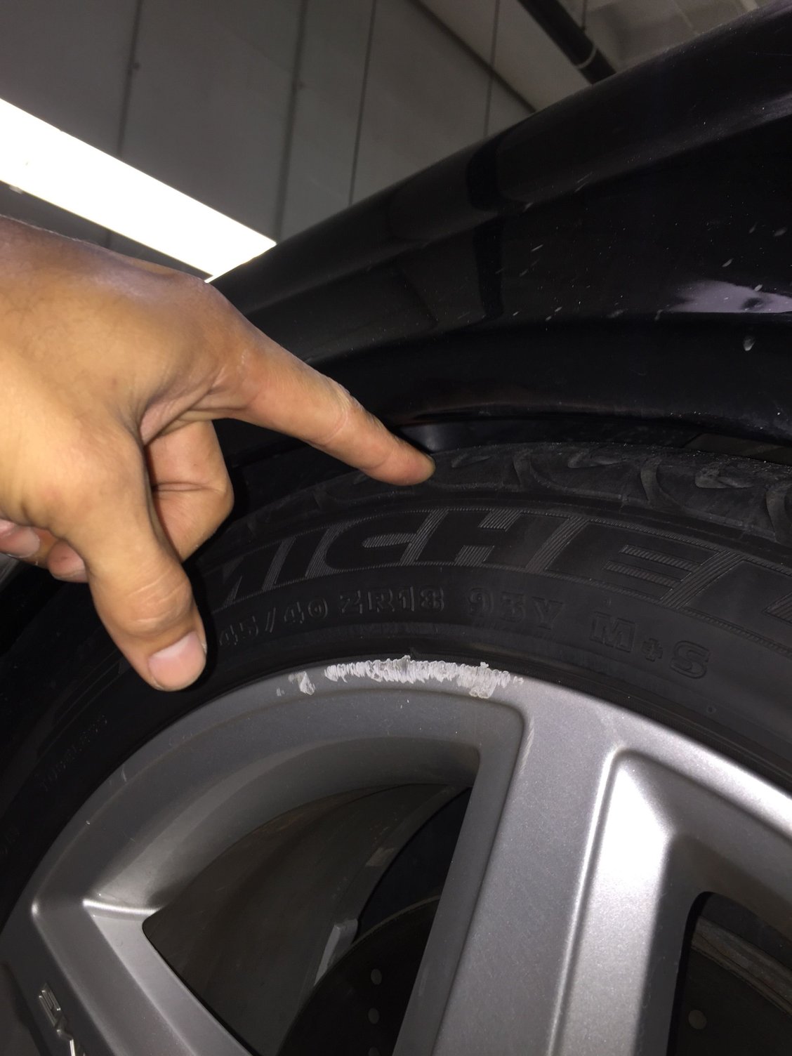

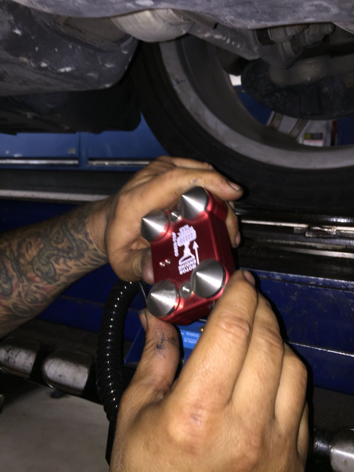

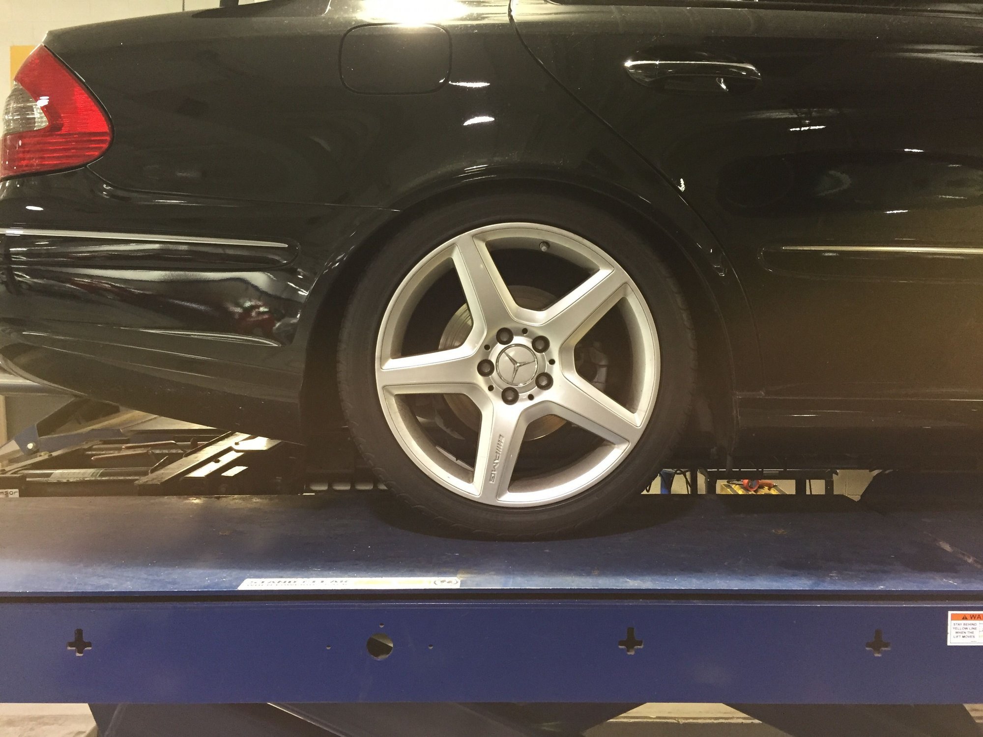

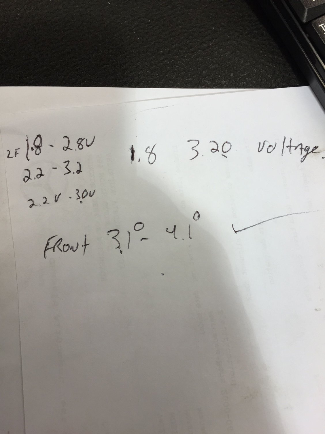

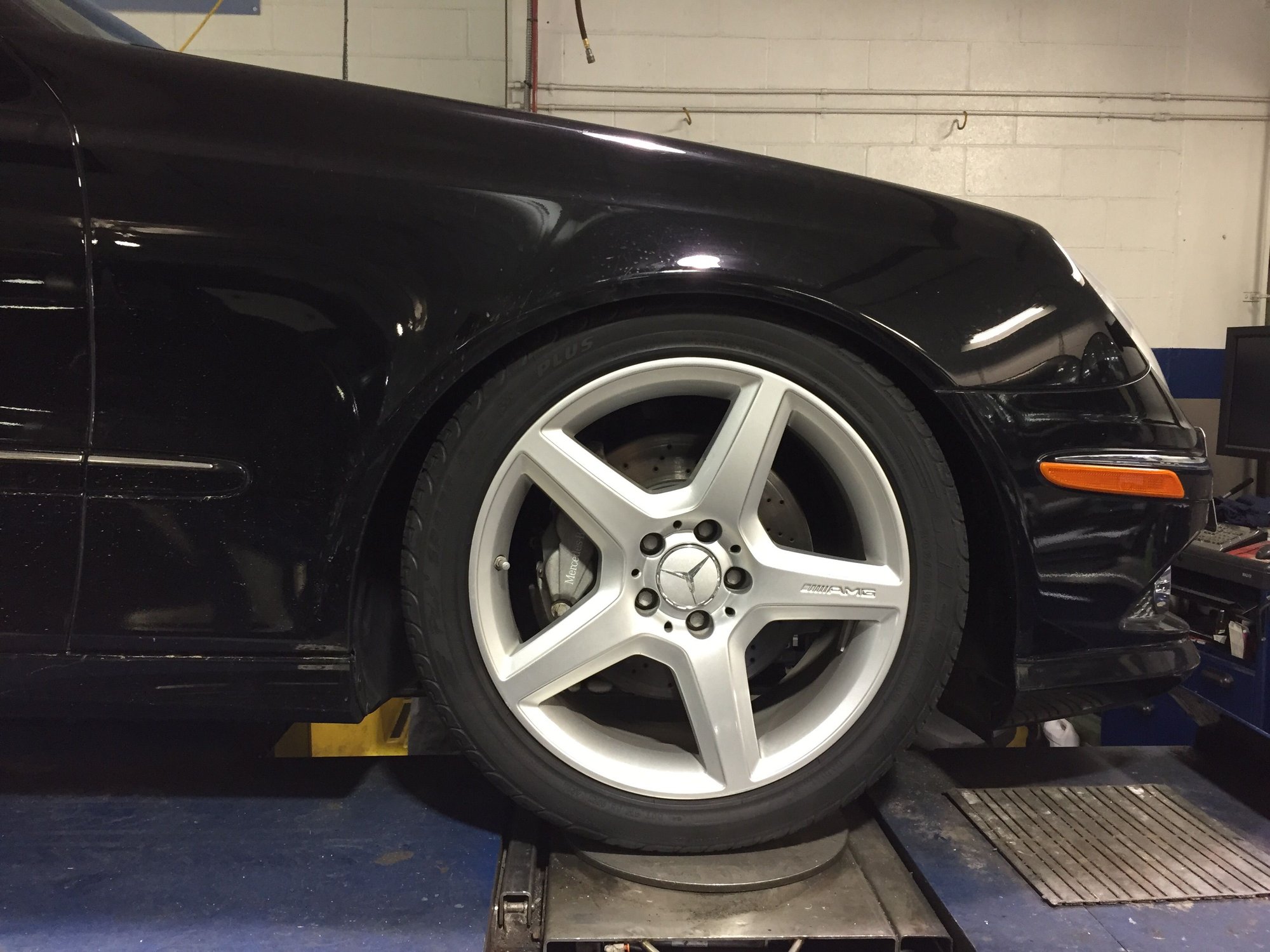

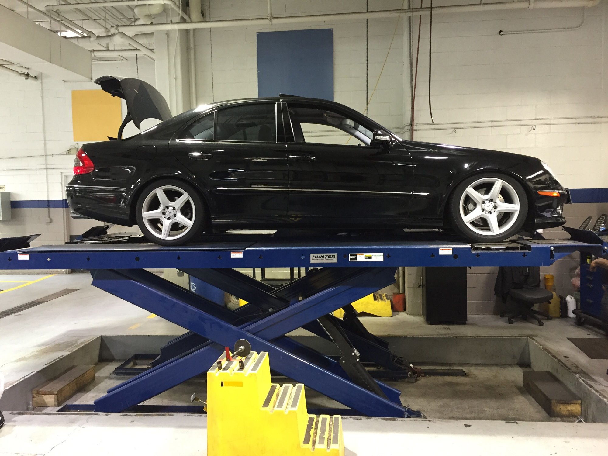

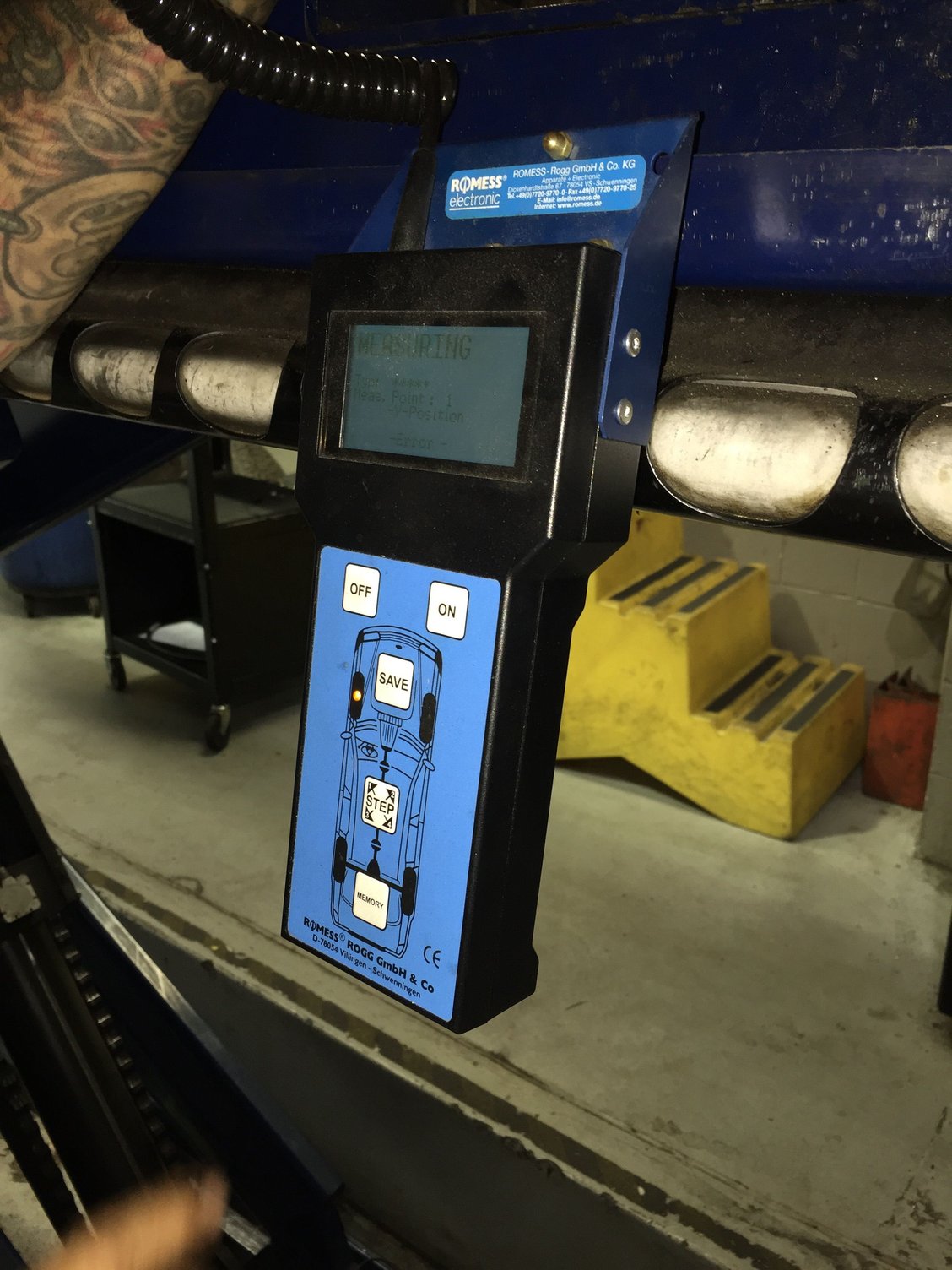

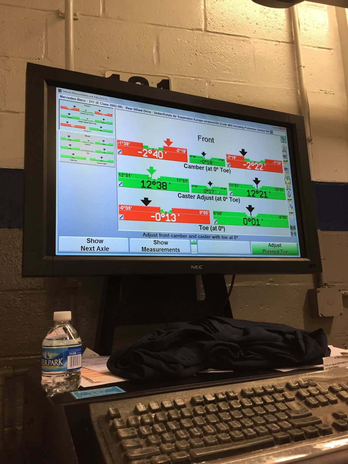

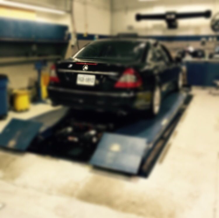

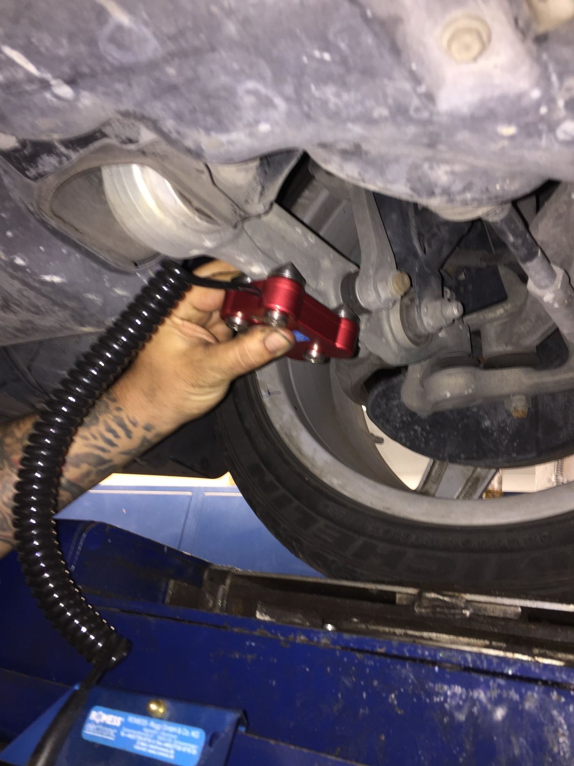

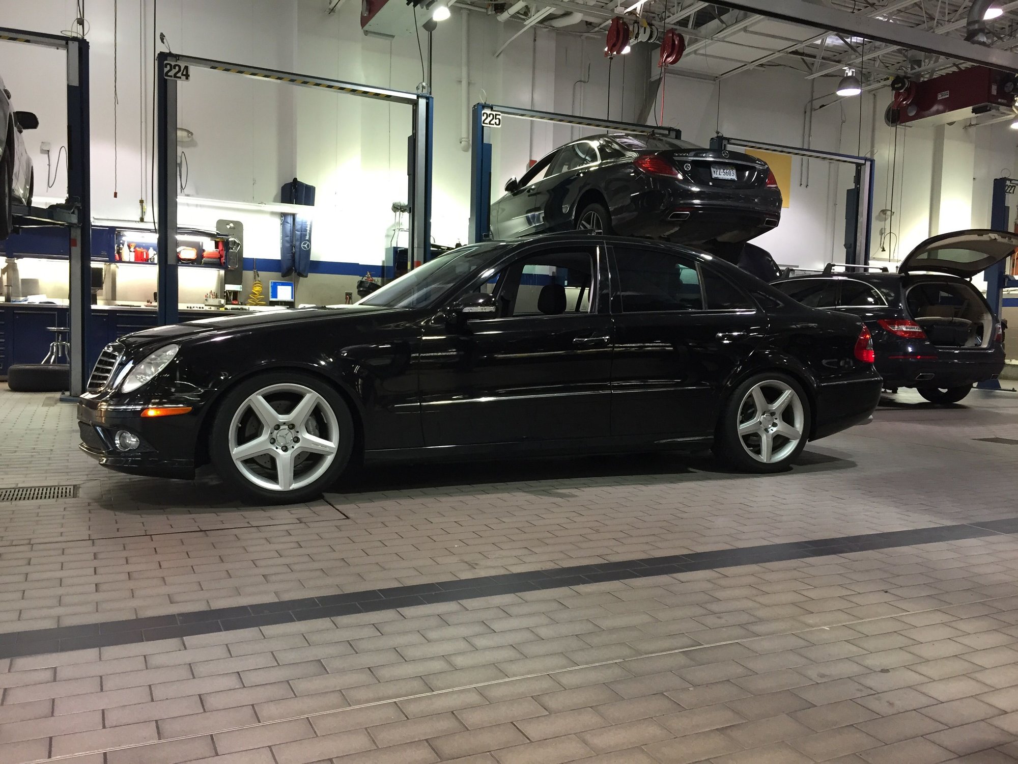

the romess

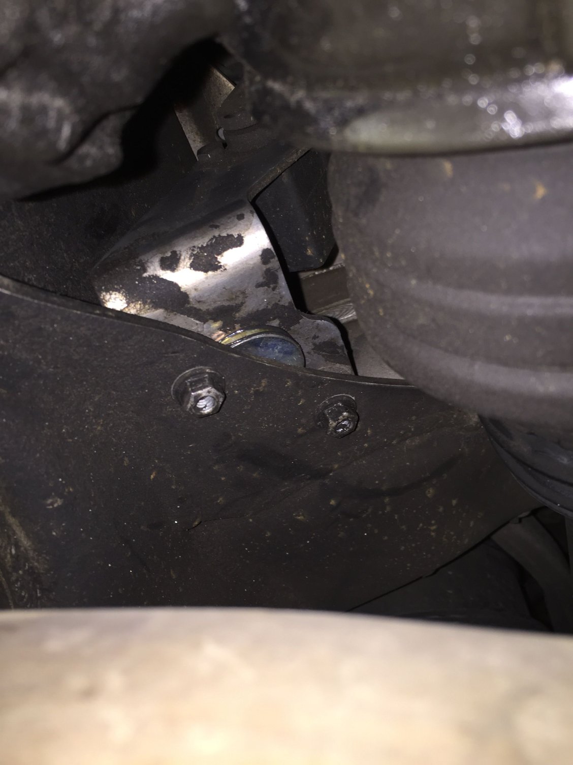

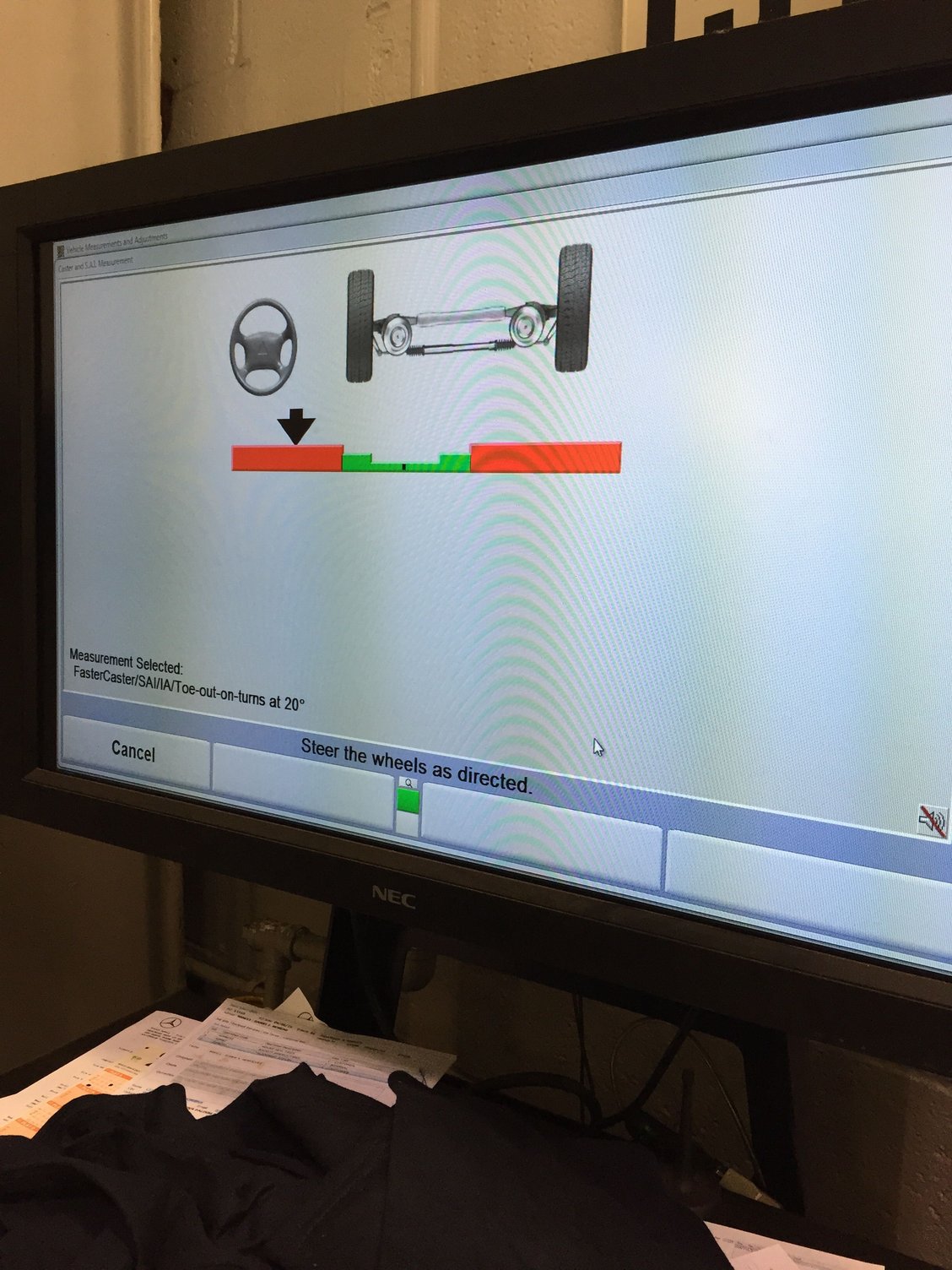

I'll make this short and sweet. The tool is directional. Place red box in between notches on lower spring link... I HAVE A 2wd V8. All models and drivetrains vary depending on where to put the tool! Use sds to change your degree values and set your ride height you desire, in the air matic/suspension control unit. once its where you like it do initial startup with manual takeover of settings, input your values and click F2 to save. It'll say "completed". once ride heights set to your standards do an alignment. My left front was off so i needed a bolt kit for the left front only.
road tested my car after everything. I will use one word to describe the difference in how it rides before and after, ORGASMIC.
