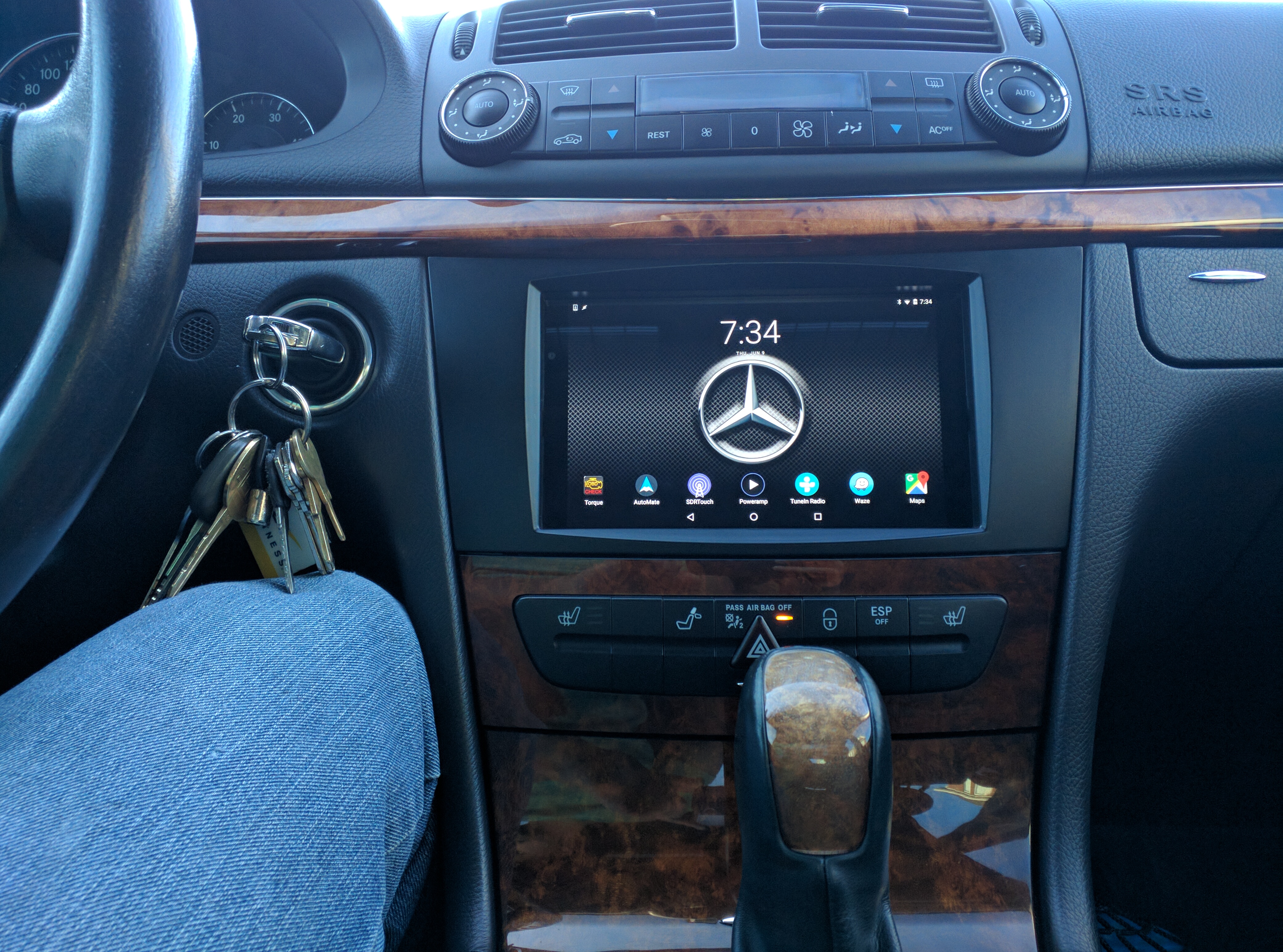

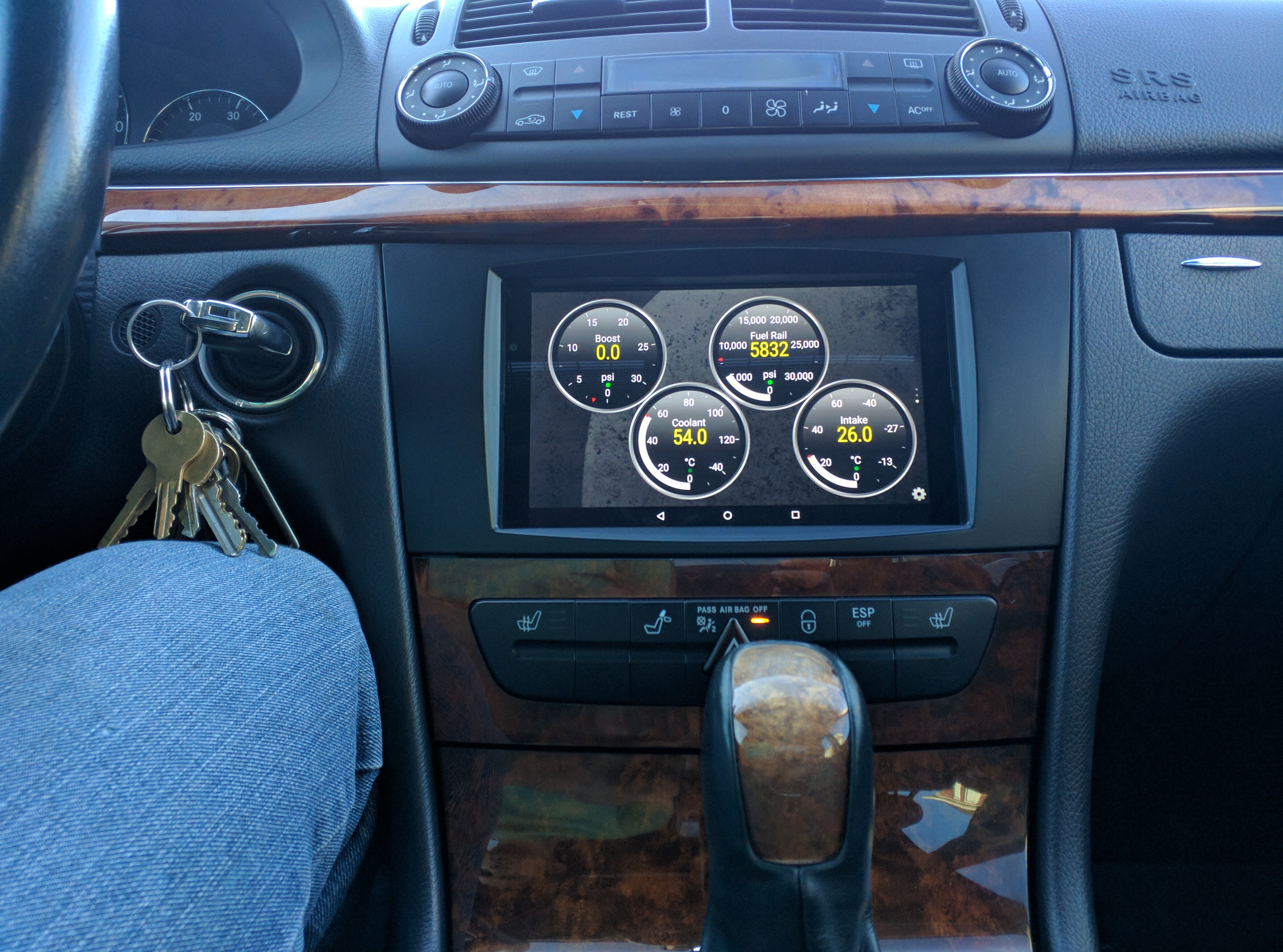

I got bored of the command system and its limited features so I installed a 2013 Nexus 7 tablet and relocated the command head unit to the trunk.
I removed the factory gps dvd drive in the trunk and placed the command head unit there and hooked up the most fiber optic ring without the gps dvd drive in the ring. The command head unit is always in aux mode.
The nexus 7 is powered with a buck converter so there is no internal battery. All usb accessories are also powered with a buck converter. Nexus 7 turns on when I turn the key on and turns off when I turn the key off. Audio from the Nexus 7 is over usb to a behringer UM2 audio interface which allows for line level out and mic input. The behringer UM2 is located in the trunk next to the command head unit the audio output is hooked up to the aux input on the back of the command head unit. Sound quality is great even at high to max volume. USB extension cable ran to the center console for hooking up thumb drives or other usb accessories. All usb cables made out of SSTP cat5 cable I just bought 50 feet of cable and a bunch of usb male female ends from ebay and soldered it up didn't have to do this but I chose to.
The nexus 7 is running stock android 6.0.1 rooted with elementalx kernel. I use SDRtouch with a RTL2832U USB dongle in the trunk for radio which is actually pretty crappy right now I need to figure out which antenna I'm supposed to use for FM radio. GPS works great so far no problems with signal. I have google maps saved offline and if I need internet I hotspot my phone. The torque app works great and I also use Carly for Mercedes which can scan a lot of systems for codes both work with the OBD Link MX interface.
The only thing I have left to do is wire up the factory microphone or get an aftermarket one if the factory one sucks and find a way to improve the FM radio signal.
Here's a few pics I took with my phone during the install.
