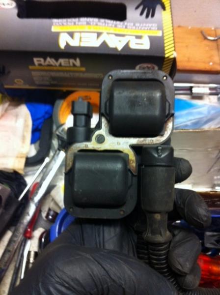

I just swapped out my plugs, and I have a couple of things to add.
I did use anti-seize, as a couple of the plugs made some serious noise coming out, and I think in another 100K taking these things out would be problematic if I put them in dry.
I highly recommend flipping over your coil, and looking at the strip of metal on the back, this is how the coil is grounded, and any rust, or oxidation at this point will raise the resistance of the circuit. I did find some corrosion, and cleaned it up with a small wire brush.

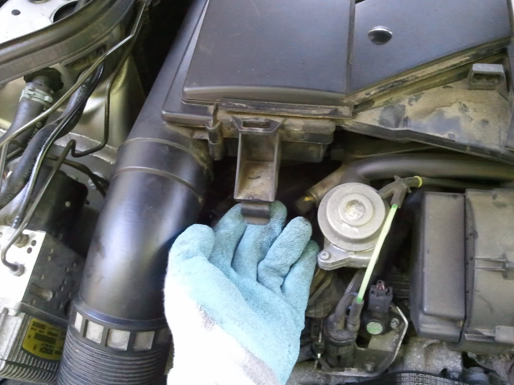

Attachment 381530
Open the hood and remove the intake manifold by first removing the front piece as shown in the above picture. Simply pull up and off at the same time.
Then locate the two front tabs holding the intake manifold in place and lift up on them, they will eventually pop up so you can remove the manifold, there are also two in the back so becarefull not to brake them.
Take the intake tubes off

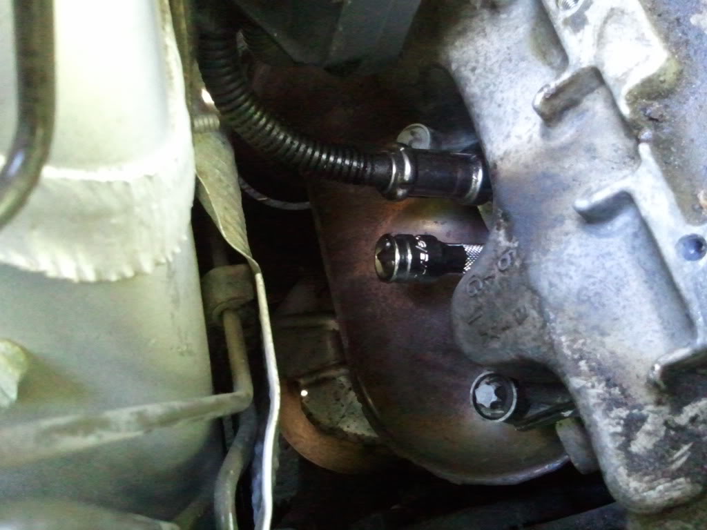

Attachment 381532
Here you can see the coilpacks for cylinder's 1-3 were going to start out on this side first.
Attachment 381533
Remove the three wire harness that power the coils so you can begin using the torx bit to take out the screws. A normal bit will not work here since it is not long enough and a normal screwdriver will not have the clearance

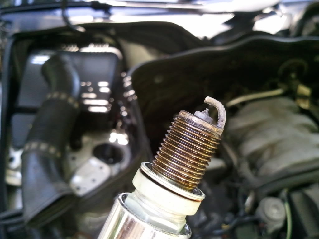

Attachment 381534
Grab the socket and feel around until it goes into the plug hold and grabs the spark plug, make sure its on there.
Take the 3" extension and hook it on the end of the socket like below:
Attachment 381535
Take the ratchet and hook that onto the extension, take off the plug by turning counter-clockwise (lefty loosey righty tighty)
You can speed things up by unhooking the extension and ratchet and hand un-screwing the plugs once they become loose enough.

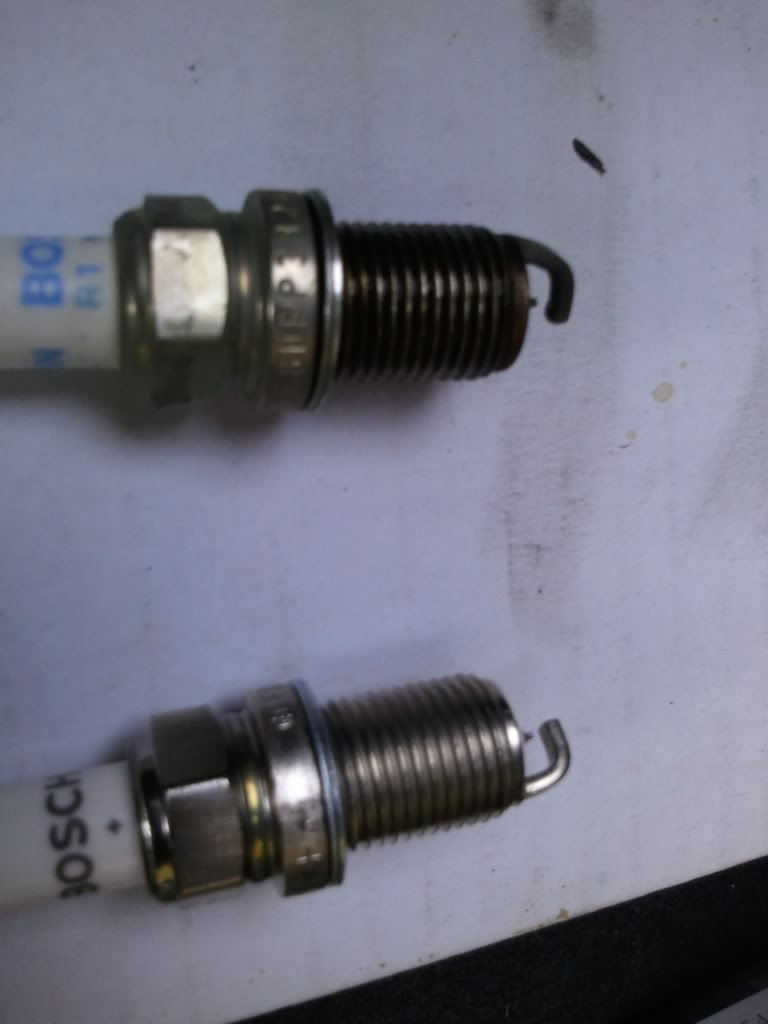

Attachment 381536
New plug next to old plug
Attachment 381537
