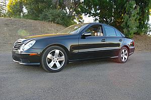

Originally Posted by jadeethan
pt500, can you show pictures of your car now with SDS? would be interested in seeing how much SDS drops the car. thanks.
took the pics yesterday, i'll post them later today... keep in mind its sds lowered with 3 washers up front as well

Old Jul 29, 2011 | 02:11 AM
pt500's Avatar
Joined: Oct 2010
Posts: 14
From: California
2003 Mercedes Benz E500 Sport Package
Pics....
here are the pics as promised... 2 angles, 2 shots each showing car in raised mode as well as at (now) standard ride height... SDS all around, 3 washers in the front (3 per side)
Attached Thumbnails Help Please!-- W211 E500 Lowering-sam_2490.jpg   Help Please!-- W211 E500 Lowering-sam_2491.jpg   Help Please!-- W211 E500 Lowering-sam_2488.jpg   Help Please!-- W211 E500 Lowering-sam_2487.jpg
