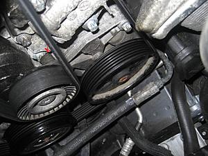

I have a friend ,,James,, that just bought a E-55 and was on his way home ,,To Chicago area, and this pulley exploded,,
http://www.ebay.com/itm/Mercedes-Benz-Genuine-Drive-Belt-Idler-Pulley-CL55-CLS55-E55-G55-S55-SL55-AMG-OE-/251249504216?pt=Motors_Car_Truck_Parts_Accessories&hash=item3a7fa32fd8&vxp=mtr
If anyone in the area has this pulley and can help out, thanks in advance. jim

I bought one at autozone. Note the bearing inside in the photo is Singapore and AZ is China. Not much difference but you can get it, bolt it on and drive off. They are open on Sunday. Be sure to have a wrench to take the belt tension off to install the belt. I used a 1/2 " drive set. Also make sure you have a wrench to remove the bolt holding the old pulley.
Try this part #. Gates 38082
Attached Thumbnails need help in Largo Florida today 3-23-13-belt-tensioner-pry-bolt-possibly.jpg
