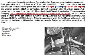

Question on the torque converter flush using the clear hose:
I attached a screenshot of the procedure. This part doesn't make sense to me. it says to:
"....unscrew banjo bolt (3) from connection. Connect connection fitting (4) with an approx. 1.5-meter long hose using hose clamp (5). Mount banjo bolt (3) and oil cooling line (2) to connection fitting (4). I do not know where you can find connection fitting or the part # for it, but you can try to slip the hose on the bolt and tight it with hose clamp...."
So, if you unscrew the bolt from the fitting and attach the hose to the fitting, how do you subsequently "mount the banjo bolt and cooling line to connection fitting" if there's a clear hose on it???? Is this procedure describing some kind of an additional tee fitting that isn't shown in the picture?
