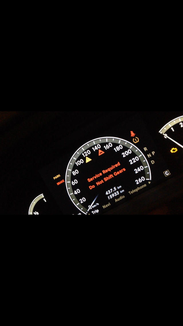

Hello so i was driving my 2008 W221 normally all day long and i plugged in OE Tuning OBDII Flashing device Android based and my car would not start and i got all sort of messages!! knowing that i have replaced my battery located under the hood and my battery located behind the rear right passenger seat is 100% ok
service required do not shift gears
ESP Inoperative see Oper. Manual
Battery sign

The battery Voltage dipped low during sign off after the tune had finished writing. We saw battery levels as low as 10.8V. We have requested that a 40A battery charger be used when flashing cars with low battery. Also disconnecting the battery for 3 hours and then attempting to use the flash loader again.
