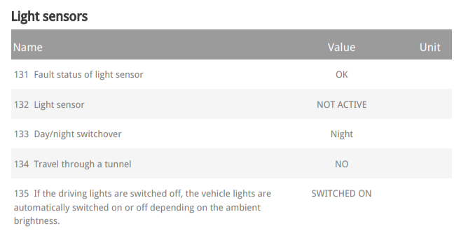

Hello.
I've rain/light sensor issues....an echo failure dtc below and always on headlights while in automatic switch selection and climate control LEDs that dim almost blank when driving into bright ambient light and brighten fully when entering dim ambient light. I've been to other threads here re: the dim display issues with no resolution yet.The sensor is sending data and the vehicle modules either doesn't respond or respond counter-intuitively.
I'm obviously missing something here...
Q: Does anyone here have a gracious suggestion?
There's a 9091 dtc for no communication with overhead control panel rain/light sensor sensor and a 9090 for no echo..no communication vs. no communication echo.
Huh?
I've swapped the overhead panel, rain/light sensor and wire with no change.
This above occurs when overhead control panel rain/light sensor is unplugged.
This above occurs when overhead panel rain/light sensor is plugged in.
There are different light sensors for different vehicle modules apparently.
Thanks for any replies.
