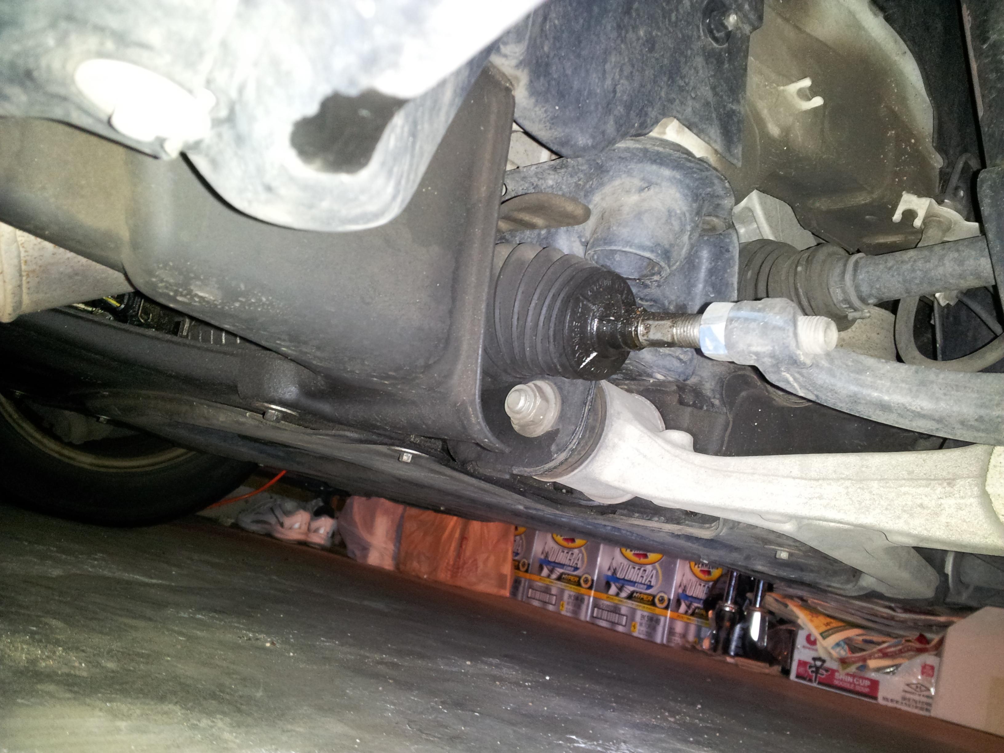

I found a leakage in front passenger side wheel area. Please refer to the attached picture. You can see the leakage from the black rubber boot(?) on the center of the picture. I have couple of questions below;
- What are the name of this boot and function(s)?
- Is the repair for this leakage an easy Do-It-Yourself type job?
- If so, what parts and tools are required?
Thank you very much for your answers

Fluid is leaking from steering box assembly. MB provides repair kits for oil lines, and tie rod but not assembly you will need to replace - MB remanufactured part # 211460240088. Check your PM.
