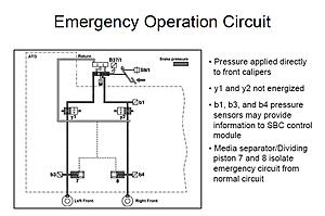

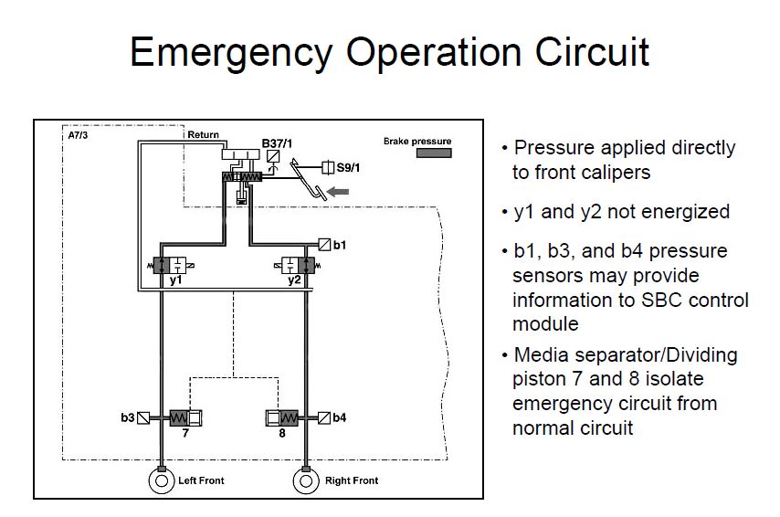

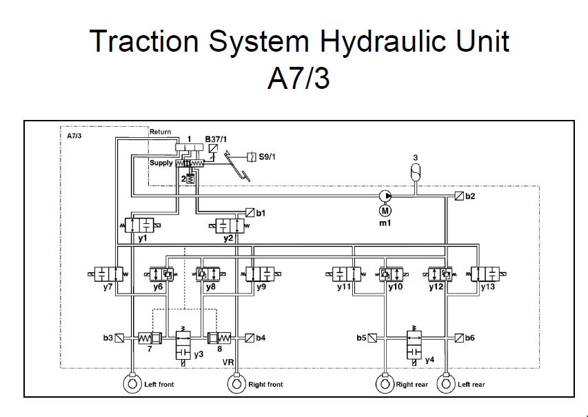

Full system. Emergency operation. Much more available if you search enough on the Internet.
Personally, I'd plan on using the parking brake under my left foot...
Yep and that would be the normally open rather than normally closed shutoff valve supplying Y1 and Y2 (front brakes). That thread i posted has a much more technical discussion about it.
