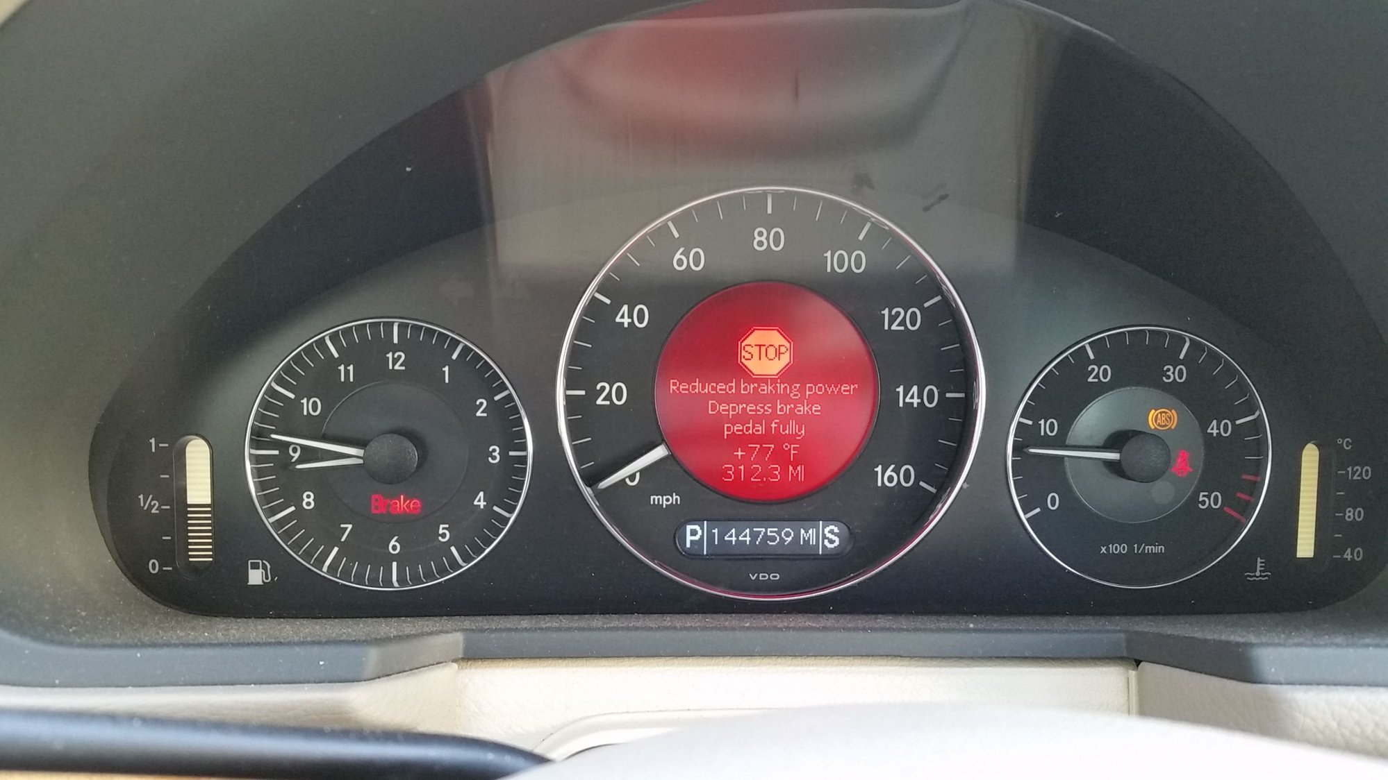

I got the message when I got into the car this morning. Went ahead and started it and sure enough the brake pedal was just about useless.
Shut the car off, waited a minute and locked the door (while sitting in the car). Unlocked and started car up and no warning brakes back to normal....
Hooked up my obdII reader and no codes...
Could this be the limit of pedal depressions and the car warning me to replace the unit? Could something else have caused this? Should I flush fluid, have an indy reset counter and move on? Should I try to get dealer to replace?

Have MB pull your codes that you cannot retrieve I would start there

You will need someone with a star system to pull codes for the sbc system. I would get ready for your $1,000 repair!

You see this does not make sense to me. This SBC unit is clearly a wear item, but one that can intermittently go out and get you in serious trouble. I don't agree with the "let's check some codes and see if there's something else going on here" approach.
To me the braking system is the most important system in the car and the fact that it is inherently a faulty design that could get you killed AND they moved away from it tells me this is something THEY should replace out of pocket (MB NA not dealer).
The failure already occurred, the entire pump should be replaced YOU DON"T EFF AROUND WITH BRAKING!! This is life and death, if the system is inherently flawed, it should be replaced entirely at a moments notice of trouble.
It's not worth replacing components on an old pump only for it to fail again sooner than later with it's age.
Any other part of the car and I would fix it myself but on principle MB NA should be replacing these units indefinitely.
The dealer basically said to "just pay attention and watch your braking distances in case it happens again..."

ive read somewhere once that SBC is NOT actually a design flaw but was a clever idea that saved a lot of lives, (it was just replaced by a BETTER and MORE RELIABLE concept) just so happens that like everything else in this world. it will break sooner or later. My old 211 was an 02, first gen, first of its kind. had about 160K on the clock and never had any issues with the SBC as far as I know. although, I admit that this worries me, which is why I traded it.
the "limit of depressions" you've read is a MYTH! best to do is go to a dealer and get the car scanned. goodluck mate!

You see I agree with you in that it actually is a clever system when it works. Eliminates abs pedal feedback, can send braking to the necessary wheels faster than the driver can think.
And indeed nothing last forever and I expect it to fail.
ITS THE WAY IT FAILS! That is the issue and unless prematurely replaced it will fail in the most unexpected way.
Also: Im curious as to why mercedes abandoned SBC so rapidly considering most of their part development cycles. Perhaps it had something to do with the russian roulette failure procedure. The system they returned to? You guessed it, standard hydraulics, they really had to modify the firewall to get the booster to fit. Must have been in a hurry

I had a master cylinder fail on me. No way to inspect it for wear. The seals that are inside the cylinder failed, there was no fluid leak so no warning light on the dash, pedal just went to the floor and was hard to stop. I knew it was the master cylinder because I went to the forum for that car and they said when that happens, that's typically the master cylinder so it's somewhat common for that to fail and people on that forum weren't up in arms about it. Maybe because the master cylinder was a $50 part instead of an MB pump being $800-$900.

I think I will see if local merc indy will let me use star and I will replace it. I would love to take one of these apart as there was some mention in another thread (http://www.benzworld.org/forums/w211...ne-wild-4.html) Where there is a mention of a potential oversight on the internal shutoff valve:
I was talking about the A7/3 simulator, in the emergency mode some of the hydraulic action is being used to compress the spring and the bumper inside, this takes away from the much needed pressure being delivered manually to the calipers via Y1 and Y2. What they missed is a solenoid shutoff valve inline with the A7/3 simulator package that is normally closed, meaning that when the electric current is shut off during the emergency mode, the valve closes the passage to the A7/3 and all of the pedal effort goes to stop the car via Y1 and Y2.
For this application, a normally closed valve is more expensive than a normally open valve, the reason is that the solenoid has to be large enough to survive a constant current during normal vehicle operation, I imagine that MB didn't want to spend the extra $4.00 for that shutoff valve and elected instead to have a marginal emergency system that is useless.
Yikes....
I am considering buying the pump myself and seeing if the local merc indy will either let me install or help. Unfortunately... no warranty so you save but potentially lose..
Again, this isn't a master cylinder failing (which is rare and usually caught before hand with proper service by DIY like me) this isn't a caliper seizing, this isn't a brake line rupturing, this isn't completely worn pads/rotors, This is your entire braking system GONE. It would be like all of the above happening at once, only you have been replacing the fluid/pads/rotors ON TIME.

I have a 2003 E320 and my red brake light has been on for about 2k miles, I had it hooked up to a star diagnostic and it thru the pressure reservoir failure code...now I called MBUSA they said take it to a dealer and let them inspect it...ofc after $115 car wash they said the entire SBC pump needs to be replaced but I have not had any breaking failure..it just feels like the brakes are engaged sometimes when the pedal is not being pressed. I then got estimates from an MB Indy and they wanted 1650 to replace the whole pump vs 2100 at the $tealership...So what did I do ? Ordered the Bosch pressure reservoir for $150 and had it installed for 100 dollars and boom red light gone. MBUSA should extend the SBC warranty tho, my car had less than 100k miles and that's normally the threshold for when they start acting up, I felt like I was being punished for being a low mileage car since corprate would not replace mine cause it was after 10 years.
