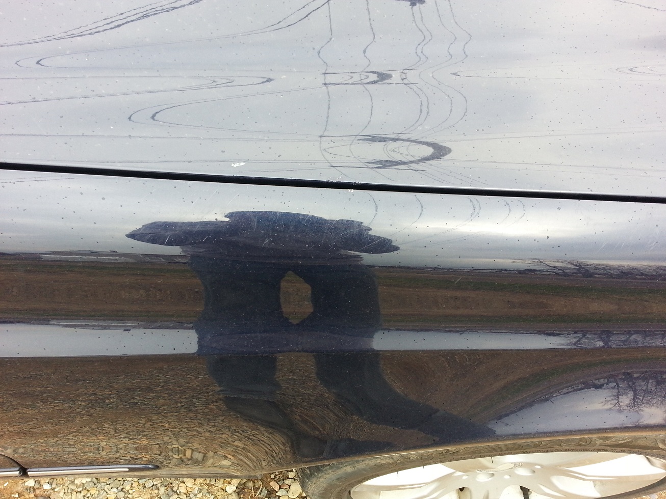

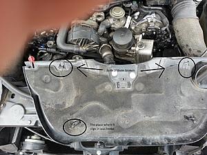

Updated with some pictures.
The scratches are like that across the whole passenger side fender next to the hood. And the rim is scratched as well as the center cap, where it previously was not.
The engine was also clean before i brought it in to them.

omg look at the sealant job they performed on those cam magnets/cam sensor covers. BLUE sealant.... no way jose haha. You arent paying these people correct?!

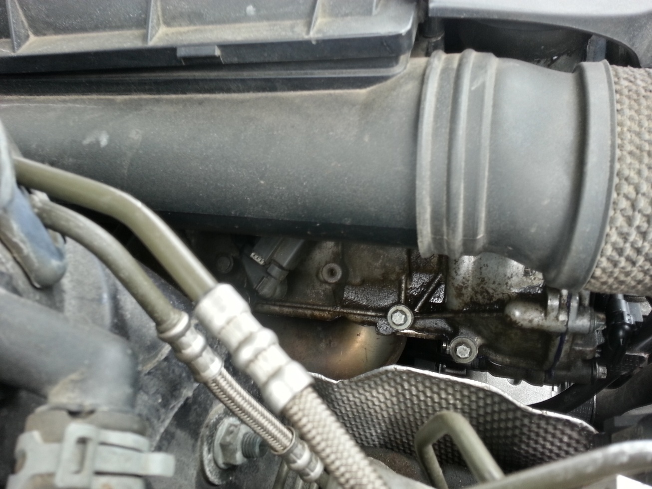

No sir, my warranty company is. So, good idea to send these pictures to them monday and tell them the story? Try to get something done about it...
I'm still not sure what to do, this is where my Dealer told me to go, so it's where i went.

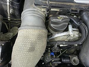

Edit: Also that blue sealant is everywhere, here's a couple of closer pictures. I honestly don't know enough about these cars to say what's out of place and what's not. Only vehicle i've ever worked on is my Canyon and Accord. Going to guess that's not exactly MB Approved sealant.
I can only imagine the damage they've done to my poor car.

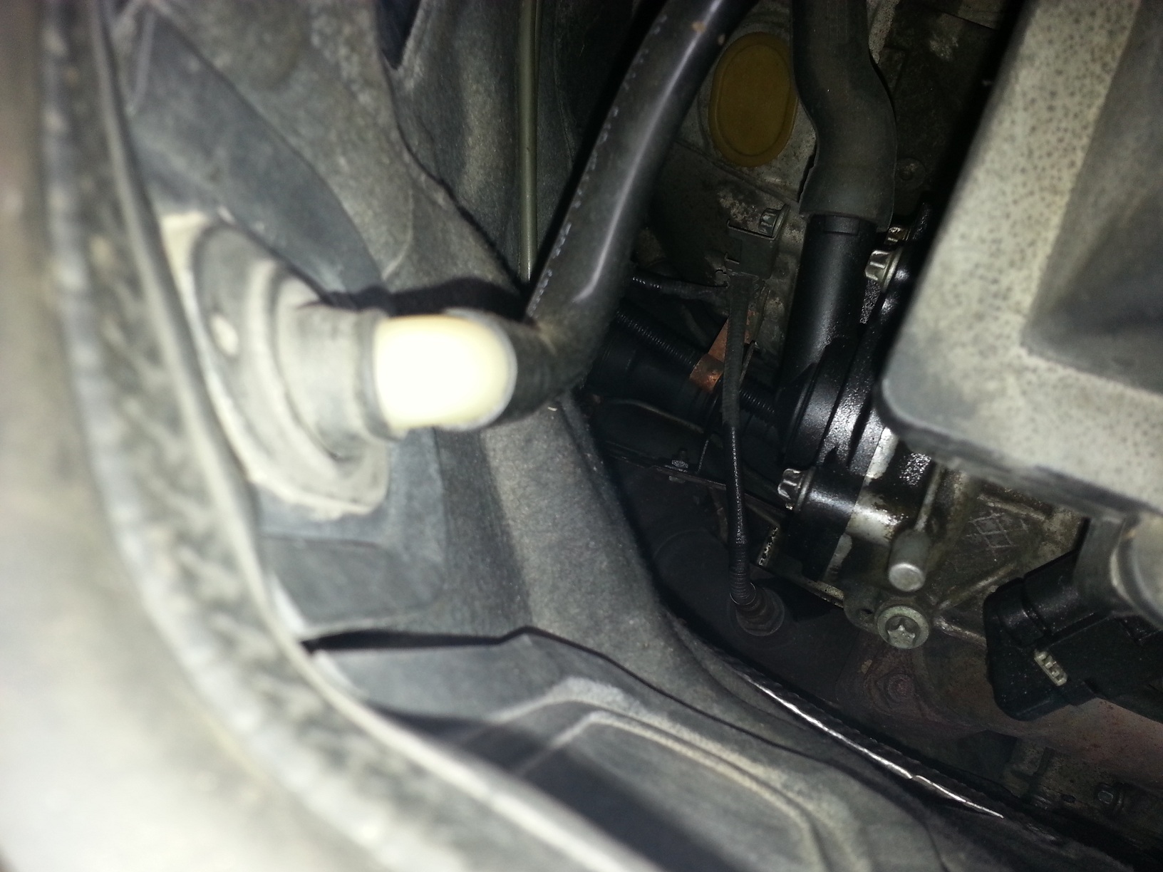

Found out the location of the smoke i was talking about too. Went out side, started it up and let it run for a bit. Revved the engine a bit and the smoke started coming, continues as the engine's off. Might be fluid on the engine block heating up? Not sure. Coming from the back passenger side of the engine, pictured here.
Going to leave it run for a bit, think it's leaking oil too. It's on dirt now so i can't really tell, going to put a piece of cardboard down to see.
Going up to the dealer tomorrow with an ultimatum. They can bring my car to a proper shop, have it completely looked over and fixed properly, as well as the cosmetic work that needs to be done. They can buy the car back for the price owed on my loan, with some additional money for my trouble and money already spent on it. Or i'll be calling up the warranty company with pictures, explaining the whole situation to them. Call the better business beurau as well, and try to bring in some lawyers. At this point i bought the car from the shop, under the pretense that the Check engine light would be dealt with. They sent me to a mechanic that didn't know what they were doing, and wasted their time screwing around with my car. They are charging my warranty company for problems they've made.
We'll see how it goes. Probably not well.

Damn, they could have at least pressure washed your engine bay/engine and replaced that leaking centrifuge cover which i'm sure is dripping on your exhaust. This looks like hack work. Explain to me again why the dealership wouldn't cover the balance shaft repair. I know my dealership covers 95% of balance shaft/idler gear (M273) repairs. Obviously customer has to pay some money, but MBUSA is suppose to be footing the bill for these repairs. Not to mention the dealership makes money on warranty/goodwill repairs, because MB corp pays the bill not the dealership, so I'm a little confused as to what your dealership isn't doing. Couple that with the fact the shop they referred you to seems like a complete hack job. It does scare me though how there's black sealant on bank 1 and blue sealant on bank 2. Almost as if they only removed one cam adjustment cover which would explain why your check engine light is or was back on, because in order to do the balance shaft repair the entire front cover needs to be removed......... I'd be getting with a shop foreman or Service lane manager at your local dealership and have the vehicle checked over and diagnostics ran. This kind of work infuriates me, Mercedes, Honda, Lexus, Aston martin, Chevy it doesn't matter, take pride in your work. This is where surveys can be your best friend if you are a customer. I'd be getting on them, the shop that did the repair, yelp or yahoo or any survey kiosk and bash them. Sounds harsh but this is some bull you know what and I'm not even involved haha.

Yes, that would be your centrifuge cover leaking onto your exhaust. my guess is it's original and needs to be replaced. something you can for sure do yourself.

Centrifuge is a common problem, even mine had it. There is a diy article about it somewhere. The worse part is having a shop do it that hasn't done them before. I think there's some other thread about the same thing happening to someone else, didn't quite run right afterwards and he thought the guys who put it back together skipped a step or something. You would have been better off with a 2008 or 2009, but I think you've now run into some of the major problems that a 2007 would have so it might have been ok if the shop hadn't screwed up the repair.

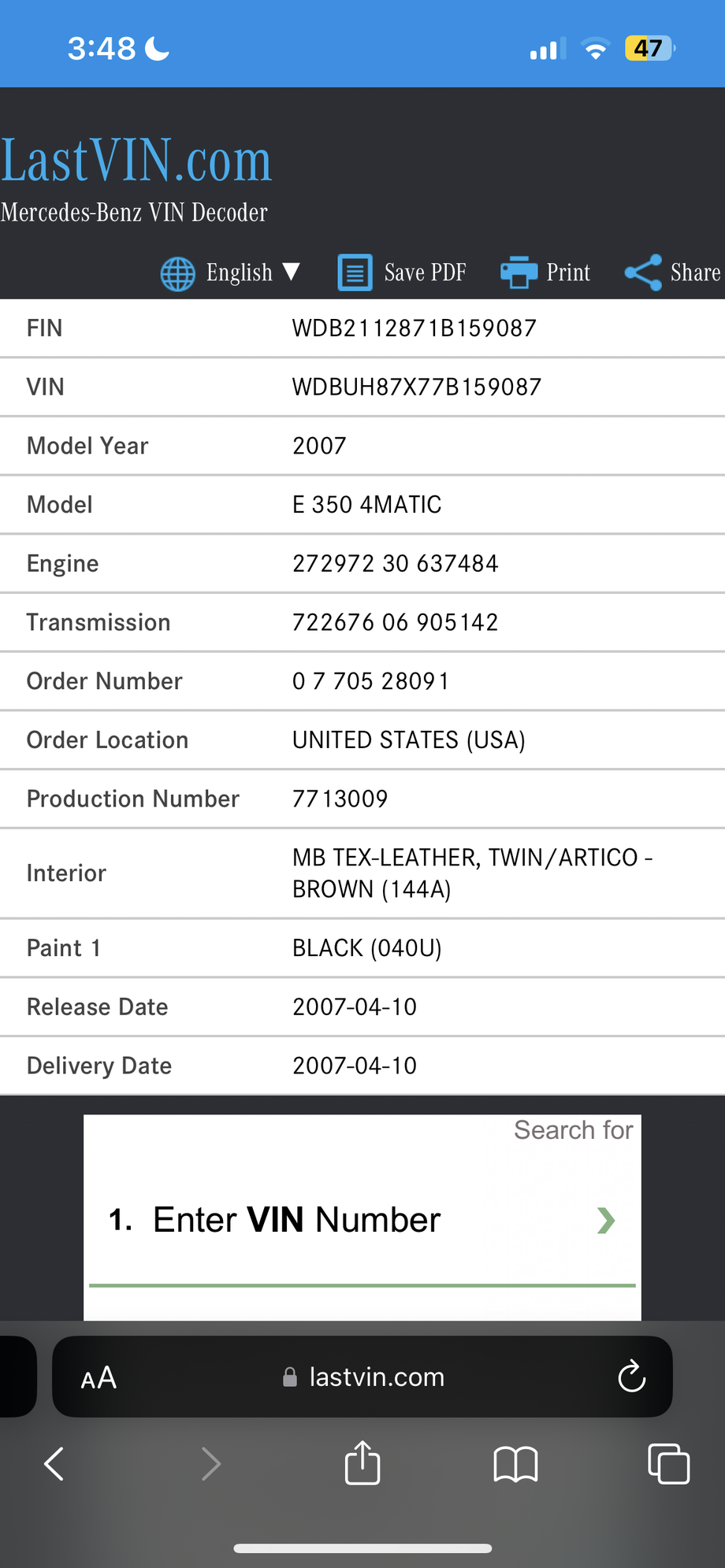

Stranger on the Internet can you tell me if this car was affected

Well it's not in the balance shaft range. It affected cars up to engine number 30 468993 and you're well out of that range.
