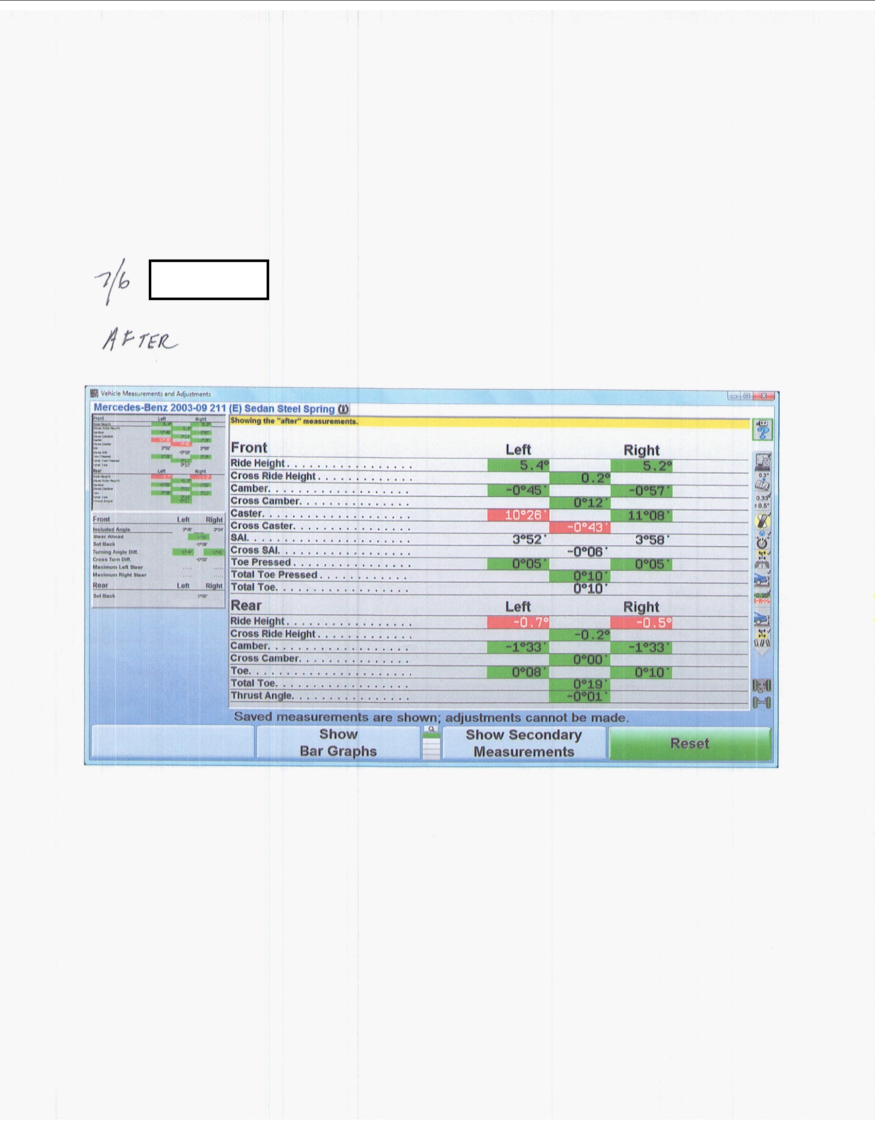

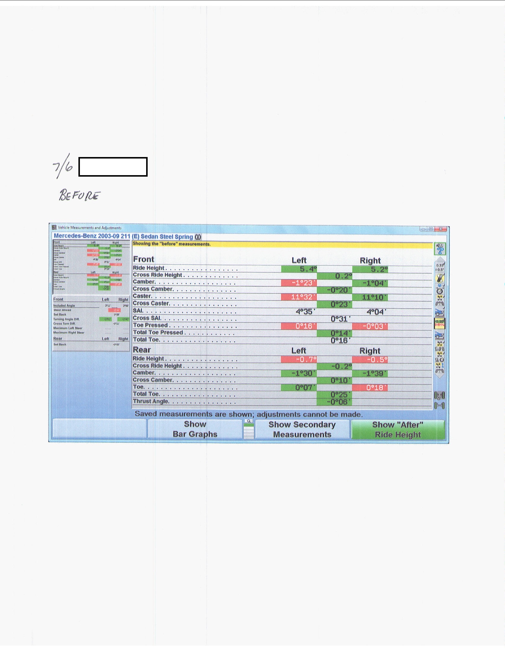

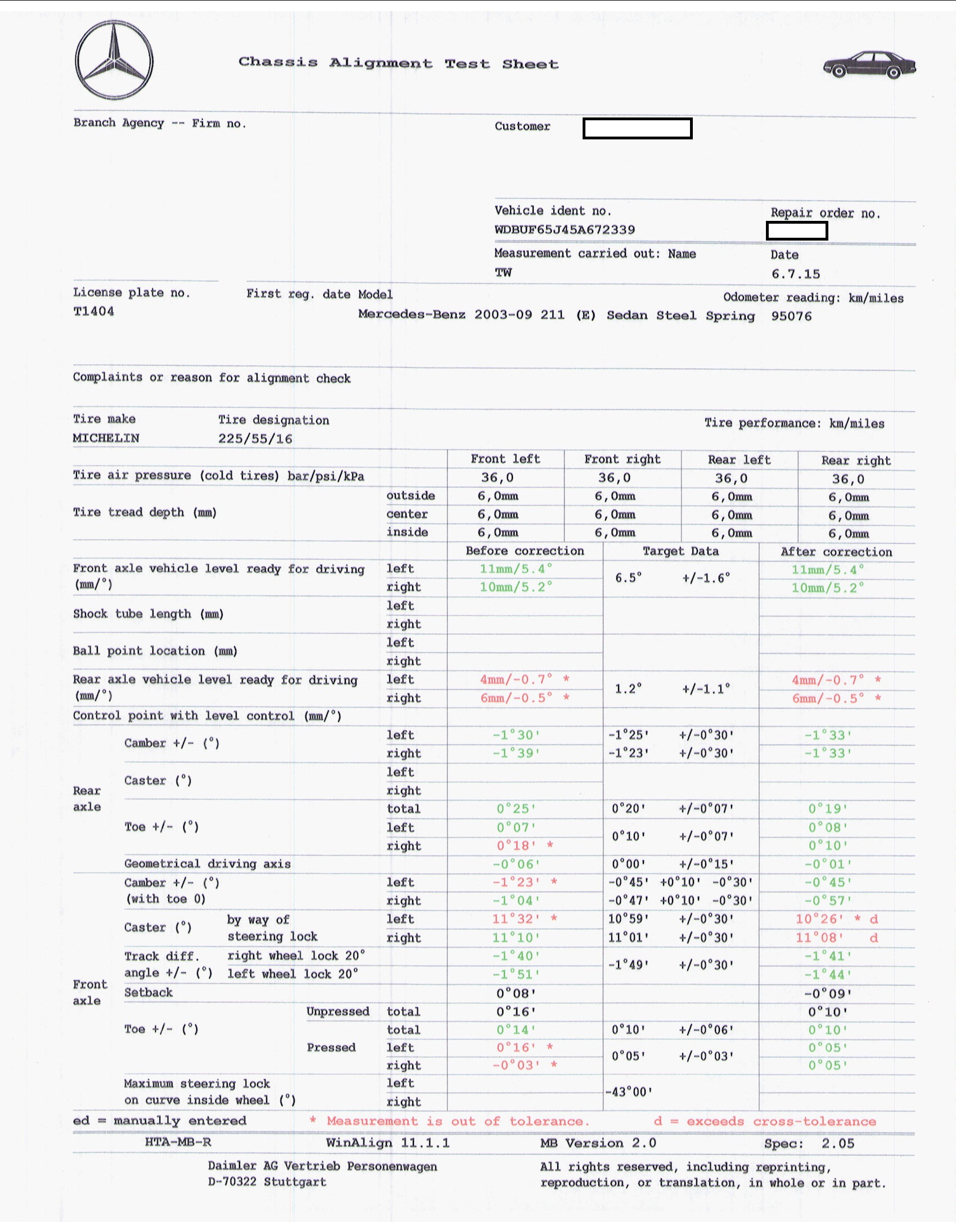

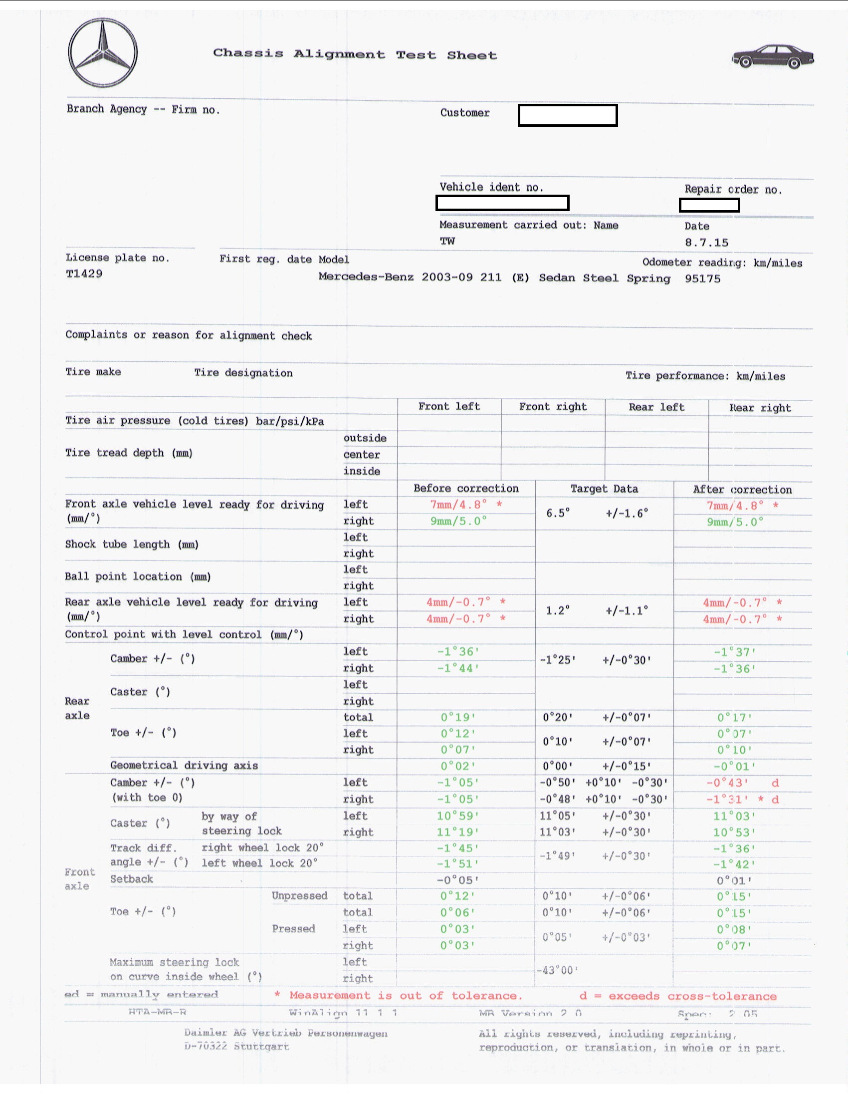

2005 W211.065 Car still pulls to the right, not too bad but enough to notice.
7/6: After first alignment at MB dealer car still had slight pull to right and wheel was off-center to right. I swapped front tires with no noticeable effect.
7/8: MB dealer aligned for second time. Said they couldn't get it within spec. and it was still pulling right. I told them to install all 4 repairs bolts (no extra cost), get it as close as possible and I would take it somewhere else.
So the latest Test Sheet (7/8) is with all 4 repair bolts installed. The first Test Sheet (7/6) has one repair bolt in the left camber.
Any thoughts on these numbers and what I could do to try and improve them? I'm not happy about the front camber split.
And what causes the tolerances to differ on the two Test Sheets?
BTW, the front suspension is new (ball joints, arms, struts, etc.) aside from the sway bar and upper wishbone bushings.

“COULDN’T GET WITHIN SPEC”
It is because the “repair bolts” are non adjustable “one position bolts”
