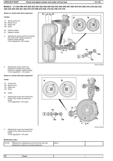

The negative camber specified by the factory is there for a reason. Negative camber doesn't wear out the inner tire edge nearly as much as bad TOE and caster. Camber and caster only have 1/2 deg adjustment with offset bolts. You don't need the dealer to do that for you.
Again negative camber is there for a reason. Don't compromise your car's safety for perceived tire life.
Attached Thumbnails Dealer alignment and negative camber-w211-front-axle-camber-amp-casterpdf.jpg
