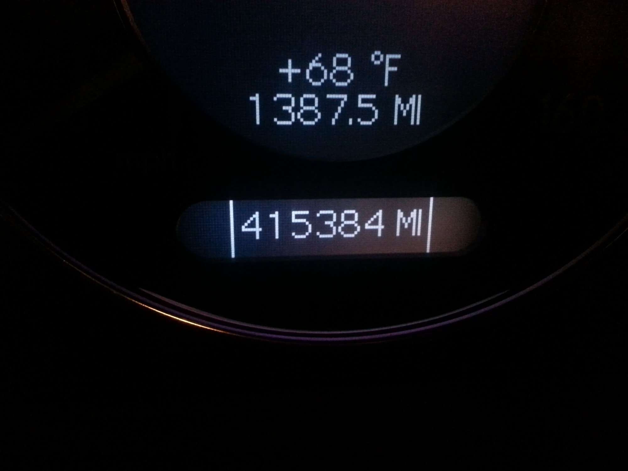

Okay here is another issue that stumps me. I have had this car for about month so I am getting used to it. I noticed that it has the c/s transmission option on the cluster and it shows up with an s or c depending on what you toggle it to. I noticed a couple days ago that the s/c light that is beside the mileage is gone. I also noted that the gear light(shows p,d, r or gear when in manual) that is on the cluster to the left of the mileage is not lite up either, its just a blank space now. Weird! Blown fuse? I have checked all the fuses and they all look good. Trunk. passenger compartment and under hood. Any thoughts or ideas.

Might be light bulb. Take a flashlight and shine the light at angle to see if the numbers are still there.

Thanks for the input guys. It digital so using the flashlight revealed nothing. Ill check that thread out.
