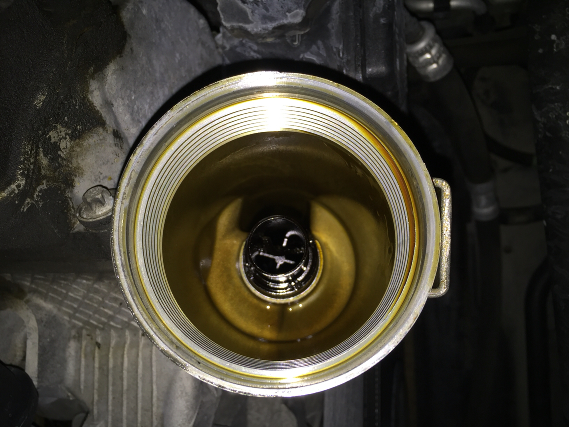

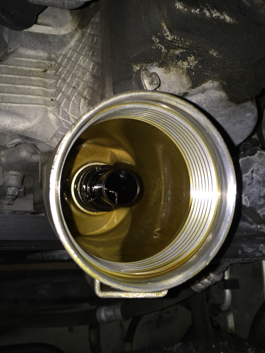

Is this how my oil housing should look like?
2003 E320

No, it is broken in half. The piece in the block needs to come out. You can buy a replacement and push it back inside the cap. The filter is missing as well btw.

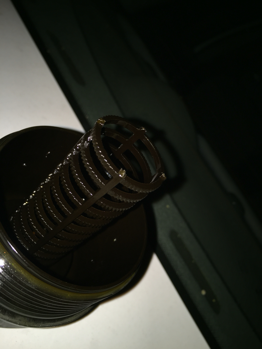

It should look like this:
