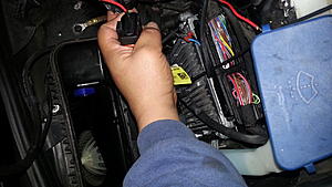

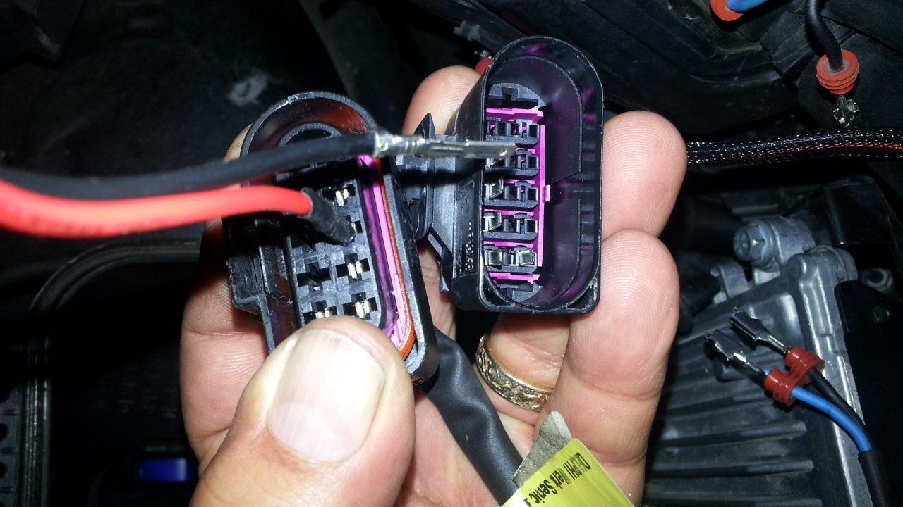

My E320 (Bluetec) is blowing F57.. narrowed down to this..HELP!
After returning from vacation, I started my car (sat for 2 + weeks), ran fine for about 1 min, then died...
Unable to start or turnover. Electric Radiator fan kicks off like it wants to leave without the car.
Found f57 (25 AMP) popped. Replaced..popped..replaced popped.
Tried my OBD2 reader, nothing..error.
Started digging/researching, finally went to my indie shop, he shared the diagram showing what fed off F57..
Of course my ECU (without power, won't talk to anything) is on it as is the relay that kicks on the fan (by design).
Indie said new ECU...about $2k. Ouch!!
I got into my ECU (what more damage can I do....hehe...indie says it's toast..WTH). Everything looked fine, no shorts, not charred pieces, looked fine.
Traced 12V in and outs (without pinouts it's time consuming). Traced 12 V feed/line that is going to 'shorted' device. What is this?
I put a 100Watt 12 light in series. Lights up real bright (short still there).
But at least now I can talk to ECU and it gives me some codes, which I think are from my leaving some sensors disconnected.
I trace the blue wire and it goes to AC compressor.. (I have a fox/hound toner), I'm going to trace the RED wire next, it would be nice if someone knew what the connector is for.
It sits right on top of the ECU and is well sealed. I'm attaching a picture and the RED line that is going to whatever is shorted.
I think if I find my short, I can try to start the car.
With the line open...engine will NOT turn over.
Any ideas?...anyone.......anyone........Buller?
