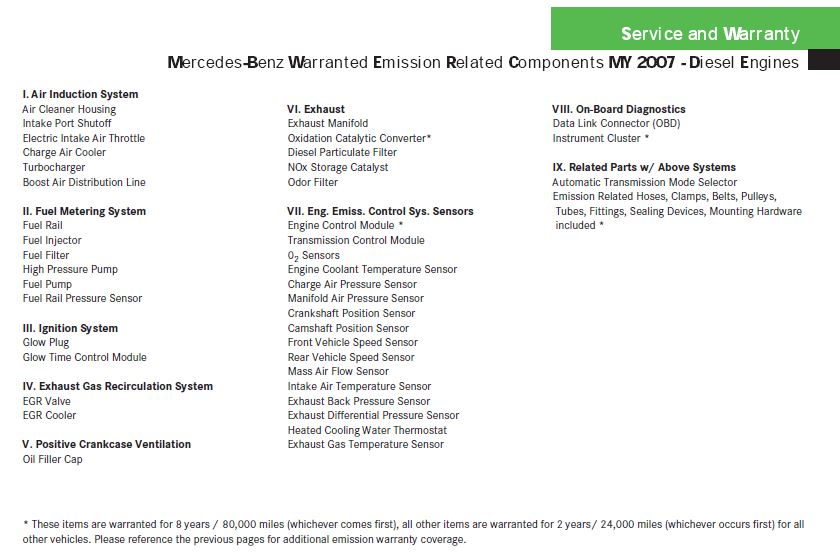

Depending on in-service date (ISD) repair may be covered. IC is covered under Emissions Warranty On-Board Diagnostics for 8 years/80,000 miles. If you do not know ISD, dealer can provide this info.

I currently have 110k miles, but thank you for your reply!
