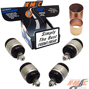

Originally Posted by kajtek1
Those cars seem to be pretty hard to adjust.
Oakland dealer hold our wagon for 3 days and still did not all parameters out of red - giving me BS about corroded bolts.
Doesn't sound like this helps with right choice, but don't just trust dealer for good job.
Ask questions before leaving the car with them.
DO POINT OUT THERE IS ONLY FRONT AND REAR “TOE” ADJUSTMENT OEM!
WE SAW THE NEED THEREFORE TO MANUFACTURE AND REINSTATE FROM THE EARLY 90’S PRECISELY ADJUSTABLE (SINGLE WRENCH, ON CAR) FRONT CAMBER AND CASTER AND REAR CAMBER (WITH EXTRA TOE) KITS. NO MODIFICATIONS – SIMPLY REPLACE THE 4 FRONT AND 4 REAR HIGHEST WEARING BUSHINGS. ALLOWING “ONGOING FULL ADJUSTMENT” TO FIX IT RIGHT THE 1ST TIME!
ESSENTIAL IF WORN BUSHINGS, ALTERING SUSPENSION HEIGHT, LOAD CARRYING, FITTING WIDE PROFILE TIRES AND/OR CAPABILITY TO RETURN TO FACTORY SPECS AFTER CURB KNOCK DAMAGE.
CAMBER Allows to actually change the tire contact angle resolving costly, premature edge tire wear, improving traction/understeer/oversteer (TOE only alters wheel direction).
CASTERCorrectly resolves steering pull, increases steering response. With better turn in and high speed directional control, along with improved anti dive/lift under brake and acceleration.
No more ongoing trips to dealers or alignment shops or constantly changing tire brands because of Toe only adjustment OEM. Or the frustration of installing (Front only) ‘offset’ bolts – to find they are inaccurate one only position – offering a minimal .3 of one degree!
We have changed all that. Up to 4 times the adjustment range of these “one” position bolts. With single wrench precise adjustment and importantly - on car accurately (under load) direct on alignment rack!
This K-MAC patented design breakthrough of on car adjustment has also eliminated the need over the last 40 or so years of time consuming disassembly each time to change settings.
Front bushings have twice the load bearing area of OEM. Yet still 2 axis/self aligning without the use of oil and air voids. Allowing also improved brake and steering response.
Rear bushings provide precise Camber for the first time and extra Toe to compensate for the new Camber facility.
Both front and rear kits come with instructions and bush extraction and insertion tubes.
W211
Front Camber and Caster kit #502216K $480
Rear Camber (and extra Toe) kit #502526K $480
MB World members (USA/Canada) delivery $30 one kit or $40 front and rear.
Can pay by PayPal or call our toll free number 1888 414 0762 to quote Visa or MasterCard.

On the W211 there is only front and rear Toe - 'directional' adjustment OEM!
No front Camber or Caster and no rear Camber.
Essential to be able to 'adjust tire contact angles' allowing to spread load more evenly, improve traction.
Catering for other than showroom height conditions - encountering high cambered roads, lowering height or load carrying. Fitting wide profile tires. Curb knock damage or for "Track days" the ability to adjust to further reduce understeer in the pursuit of "front row of the grid lap times".
KMAC FOR THE W211 MANUFACTURE A "TOTAL SYSTEM" TO FIX IT RIGHT THE 1ST TIME - WITH 3 OPTIONS FOR THE FRONT RE ADJUSTMENT OF "BOTH" CAMBER AND ALSO CASTER.
WHILE FOR THE REAR 2 OPTIONS - AGAIN "BOTH" CAMBER AND ALSO IMPORTANTLY "EXTRA" TOE TO COMPENSATE FOR THE NEW REAR CAMBER FACILITY.
​​​​​​PLUS ALSO FOR THE REAR POPULAR UPRATED BUSHINGS FOR THE '6' MULTI LINK ARMS - LESS TWITCH, FLEX, LOSS OF TRACTION, ESPECIALLY WHEN APPLYING POWER TO LANE CHANGE / OVERTAKE.
1. FRONT SUSPENSION:
#502216-1 J
$380 (Both Sides)
Budget priced replacement upper arm inner bushings. Fast fit without arm removal (bush extraction tool included) 1.5 degrees Positive or Negative precise Camber adjustment plus Caster. More than enough to resolve most costly, premature tire wear issues. At $380 less than the cost of a high performance tire.
Also the security, peace of mind of "retaining the original HIGH STRENGTH ALLOY ARMS" - not replacing with welded, fabricated arms!
2. #502216-3 P $795 (Both Sides)
Complete " replacement" upper arms like above (#1) KMAC are not only Camber but also Caster” adjustable
Many brands provide Camber only. But “Caster” adjustment allows to compensate for Camber change plus correctly resolves steering pull.
3. #502216 K $480 (Both Sides)
Also front lower (not upper) replacement Camber and Caster bushings (Replacing at same time the 4 highest wearing) Providing again up to 1.5 degrees Positive or Negative Camber adjustment.
THIS UNIQUE KMAC PATENTED DESIGN allows precise single wrench adjustment – accurately under load, direct on alignment rack.
The 2 forward facing thrust arm bushes (now precisely Caster adjustable) unlike other brands set new standards - KMAC being Mono ball / 2 Axis, allowing arms to travel through their “required suspension arcs” without binding / locking up. Plus the advantage of improved “brake and steering” response by eliminating the soft rubber, oil and air voided OEM bushings.
ANOTHER KMAC DESIGN BREAKTHROUGH - bushings have more than "twice the load bearing, impact area" of often used steel spherical ball joints - that with their wafer thin teflon liners soon pound out.
FOR THE REAR SUSPENSION:
4. #502526 K $480 (Both Sides)
Lower arm inner bushings Camber (and also extra Toe adjustment to compensate for the new rear Camber facility). KMAC design having twice the adjustment range of upper arm bushings. Precise single wrench adjustable. Easily accessible to adjust on alignment rack (accurately under load).
* Note Adjusting “lower arms” retains top of tire to outer fender clearance when wanting to reduce costly, premature, inner edge wear.
5. #502526-1 M $595 (Both Sides)
Alternatively complete upper Camber arms (also with extra Toe adjustment to compensate)
*Reduces clearance top of tire to outer fender when adjusting to reduce inner edge wear.
6.#502528 K $480 (Both Sides)
"Uprated bushings" for the '6' multi link rear arms. - less twitch, flex, loss of traction – especially when applying power to lane change / overtake
DHL Air worldwide $40 one kit, $20 each additional. PayPal, Visa or M/Card.
World's Largest Range Audi to Volvo. Competition Proven, Long term maintenance free, Non squeak, Fail safe lock system. All the features you would expect - Longest established. Most experienced, Adjustable Strut Tops and Bushing Kit Manufacturers (1964).
